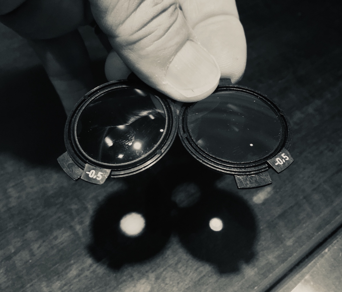

This was odd. Somehow the wrong strength viewfinder diopter was inserted in the plastic holder.
