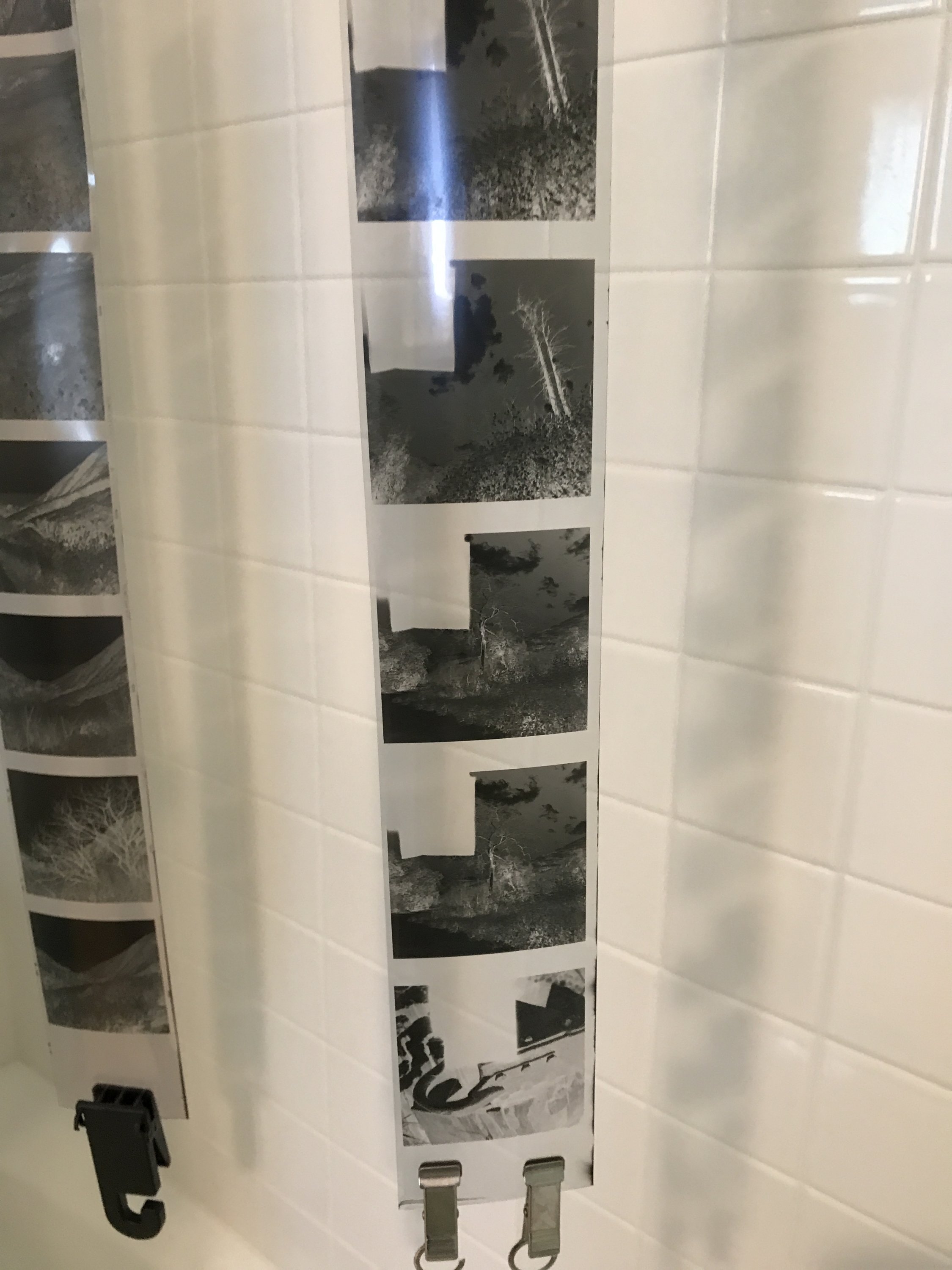

I know it's an odd title, but the oddest thing happened to me last Friday. I noticed that when I unloaded a roll of HP5+, the gummed tape was missing to seal the roll up and had to scramble for something handy to keep the roll wound tight. I ended up using a rubber band I had, and later swapped that out for some masking tape. It seemed odd that the tape was missing but I didn't give it that much more thought. I processed the film from that day's shooting today, only to discover the last roll had a strange rectangular shape in various positions in every frame!

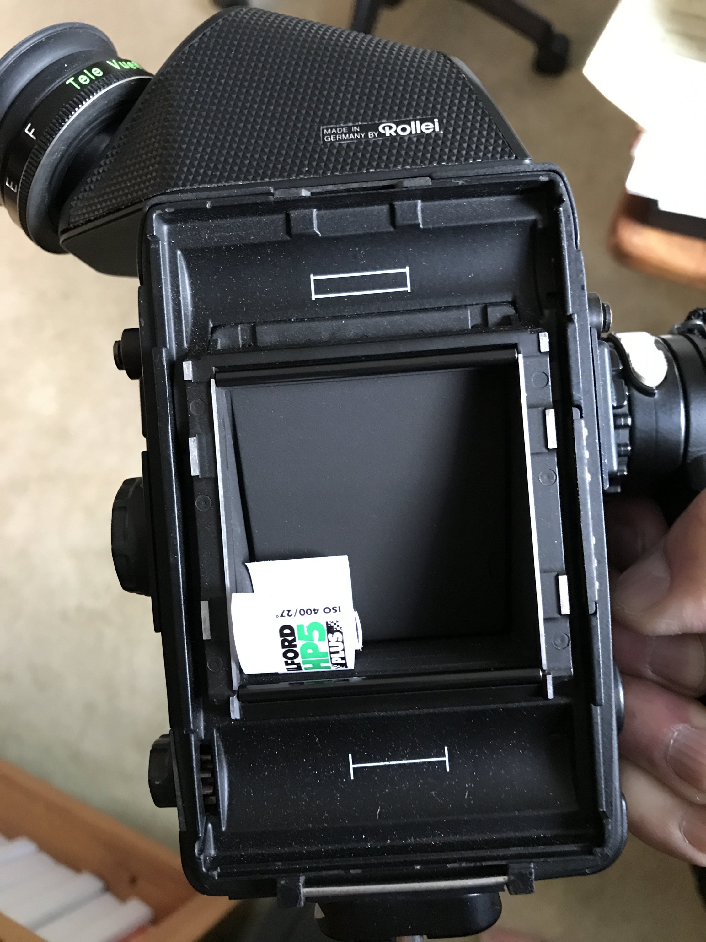

I was trying out a roll of CatLabs 80 film and immediately thought there was some bad quality control going on with it and that the shape was a bit of the sealing tape from that roll. When the film dried, it took a closer look and could read HP5 on a couple of the frames! I removed the magazine from my camera and this is what I saw:
Now I know to check carefully if something is not as expected when loading or unloading the camera!

For some reason, Ilford gives me more problems with that sealing tape piece than other brands (Fuji and Kodak for me). Including getting hung up and ripped off. Fortunately I've never had it lodge like yours did.

When I first opened up the Mamiya TLR issued to me as a photography student, a piece Ilford paper was stuck inside it. Inspired by this early experience, I try to remember to give the interior of the camera an inspection and a good blast with my Rocket blower with every film change.
