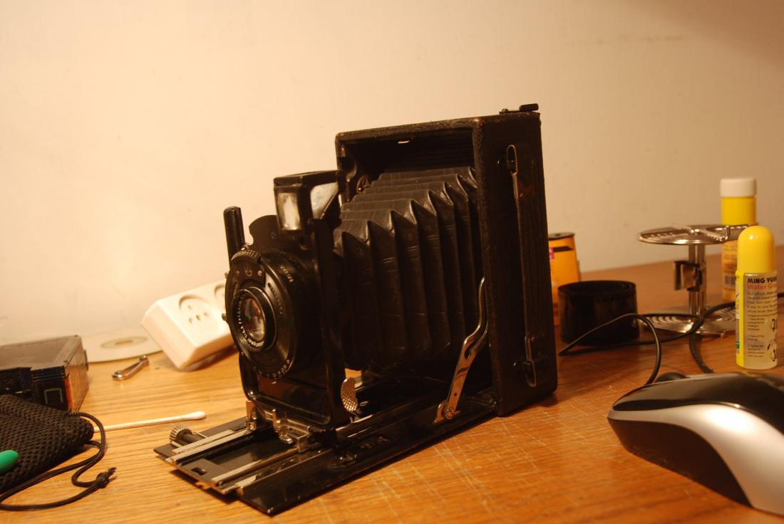

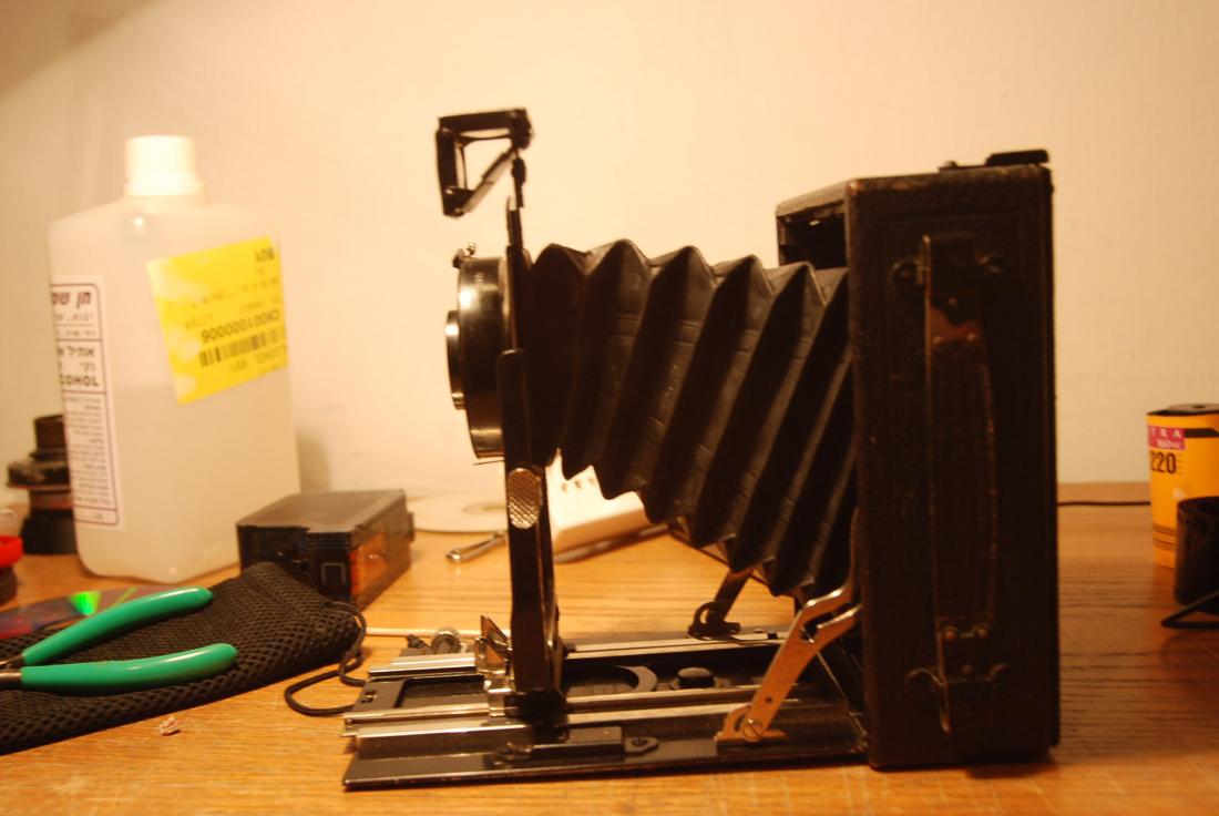

first off all thak u all..!!!
more details...uploding some pic. the lens is Anastigmat 135mm f6.8 I remuved the lens and put on my TOYO 4x5 camera and it is cute and nice in good working order...(uploding pic that was taken with the lens) it's very small camera and i wish to make it backpacking camera.
p.s
sorry for the mess on my working table...:smile:))

You might want to swap the lens for a 135mm Tessar or equivalent which will give you significantly better performance and coverage. The early Tessar's cover 5x4 with room for some movements although edge/corner sharpness isn't up to modern standards until f22/f32. I have been using a 135mm Tessar on a Crown Graphic.

Very, very neat little camera. Perfect.
The lens, I'll bet, is the same design as a Dagor, and will cover more than an ample amount. This isn't a camera to make 30x40s from. It doesn't seem to have been used enough to wear out the metal parts,
but in time the bellows will need to be replaced. It seems to be a treasure.
Camera Bellows, Birmingham, England (http://www.camerabellows.com/Replacement.html) is far and away the the best for this.
Ian Grant
Aug 2, 2004
23,243
West Midland
The cheaper Anastigmat 135mm f6.8 lenses were often triplets although some where Doppel Anastigmat, few would have been up to the quality of a Dagor.
Judging by the OP's image taken with the lens and the fall off at the corners it may well be an Triplet.
All manufacturers offered 9x12 cameras with a variety of lenses and shutters, the best models used Tessars, Heliars, Xenars, Eurynars, Dagors etc in Compur or Ibsor shutters, then with the cheapest lenses a 3 speed Vario or Derval shutter which is what appears to be on this particular camera.

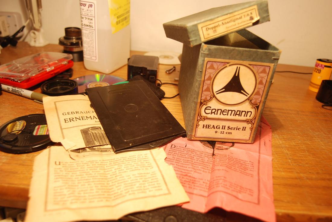

it is an doppel-anastigmat f.6.8, (4 in 4 groups) took it apart to clean it...it looks to me very clean no fungus, If I will be able to bult this adapter I want to replace the old lens with the Yamasaki C-CONGO 1:6.3 f=150 on it, it is in very good condition and I think it will fitt the camera and it is much better IMO :smile:

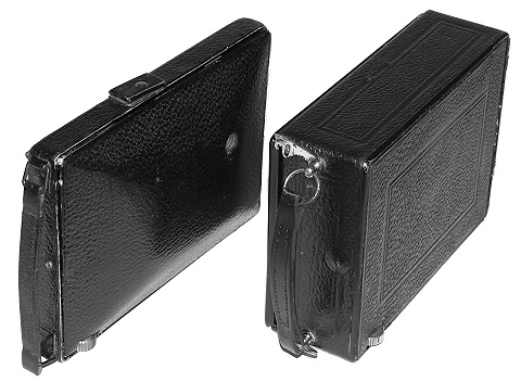

This is a "little" Orion Werks - same size as my Ernemann - alongside (there was a url link here which no longer exists)
These 9x12's are excellent cameras provided you don't want to use movements, they are far smaller & lighter than corresponding 5x4 cameras and the film format is only a fraction smaller.
Obviously the Patent Etui is even smaller than an Ernemann compared to a Pacemaker Crown Graphic :D

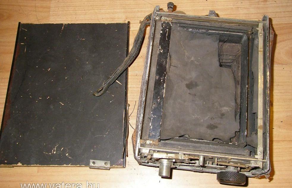

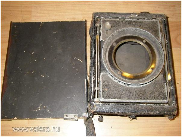

Dear All,
I'm planing to buy an Ernemann large format camera. But.
First of all the camera is toally ruined by time and dust and need to be renovated. I would like to make it by my own hands, and before i do anything, would like to ask here a few things.
I'm new here at APUG but i'm in analog photography since a few years. Had built thing and also repaired smaller equipment like my Bessa R3a.
But this is a bigger nut then just tighten a screw.
I attached 4 pictures, cannot give better because i don't have neighter.
I can buy it from the internet for around 35$ and would like to know, Is it possible to repair it?
If yes, what kind of Ernemann is it exactly, i couldn't figure out :sad:
Thank you for the help,
Bandi

Welcome to APUG Bandi.
It's an Ernemann Klpapp, which has a large focal plane shutter,. It looks like it'll need an awful lot of restoration and you'll have difficulty finding some of the parts easily. A lens should be less difficult as it probably had a Tessar.
Not the ideal large format camera project to start off with, although it's the kind of challenge I enjoy. On a more practical side the camera's lack of movements will make it less useful in the long run.
