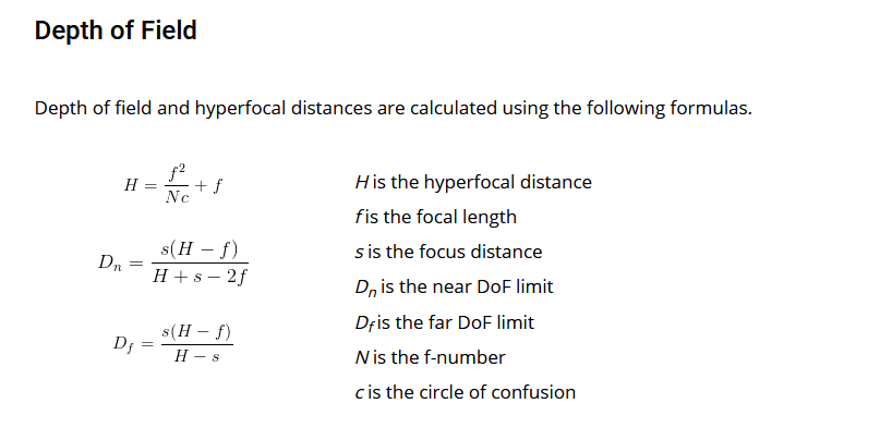

I suggest you prepare yourself a spreadsheet in Excel to calculate the depth of field using the variables you're interested in.
Then by using the app to 'goal seek' You can easily find the right settings to give you equivalent depth of field.

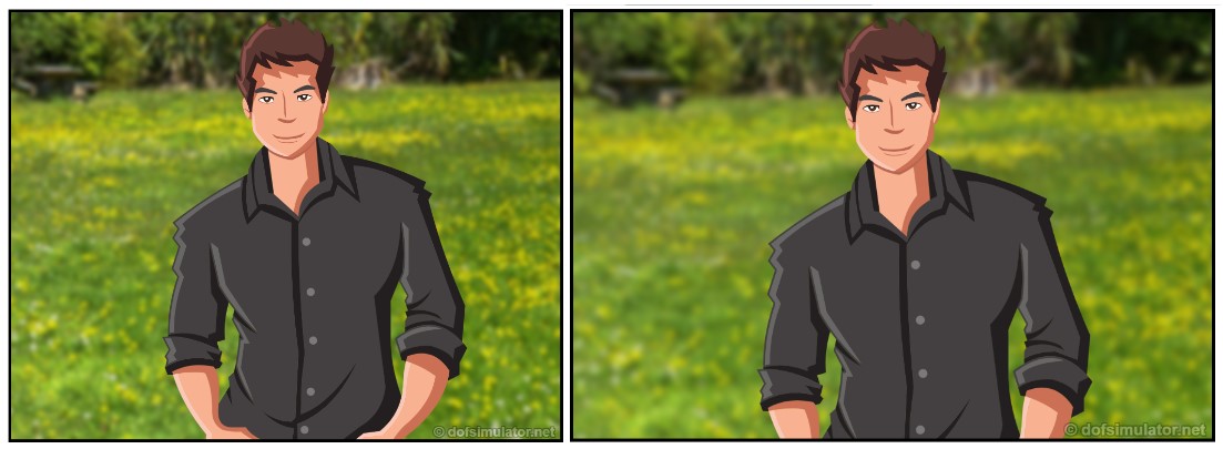

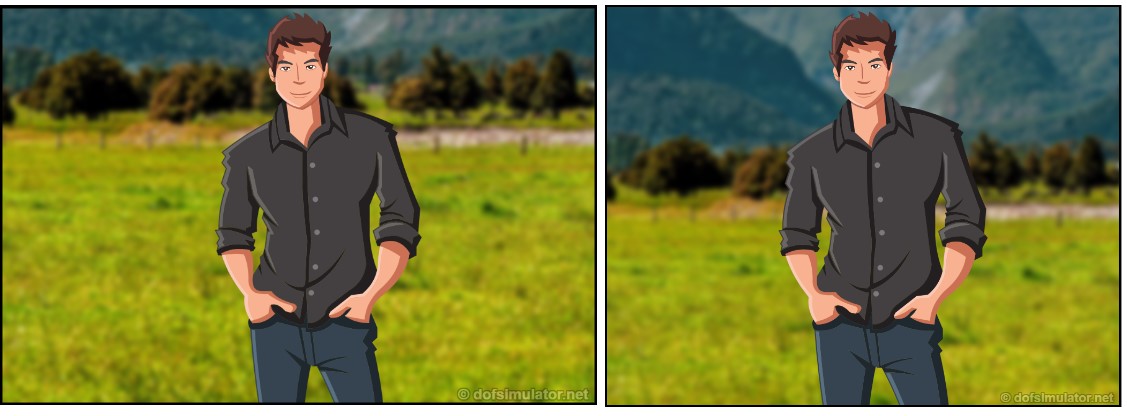

With a model distance of 2.5m, and a background distance of 10.3m for both portraits, the 180mm at F/8 produces nearly the same amount of background blur as the 85mm at F/2.8. I've been having to shoot at 8/11/16 during the first few days with it and was concerned that I wouldn't get the shallow DOF that I am used to. But it looks like that 3 stop ND filter I bought is going to prove to be a good choice. Now it's time to get out and test it.

The degree of background blur has nothing to do with DOF depth, it is purely a funciton of the DIAMETER of the aperture in use. FL divided by f/number. Bigger = 'more blurry'.
And 60mm diameter is 'twice as blurry' as 30mm aperture diameter.
And meanwhile, DOF is 'the same' regardless of FL at same aperture. DOF is only related to how the subject fills the frame...same filling = same DOF.
