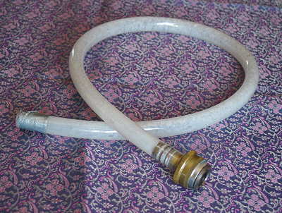

The weirdest non-darkroom thing I have is my "plumber's nightmare" film washing hose that I attach to my kitchen faucet, and to the funnel of my Paterson tank. I cobbled it together from three adapters, 18" of vinyl hose and bit of duct tape.
