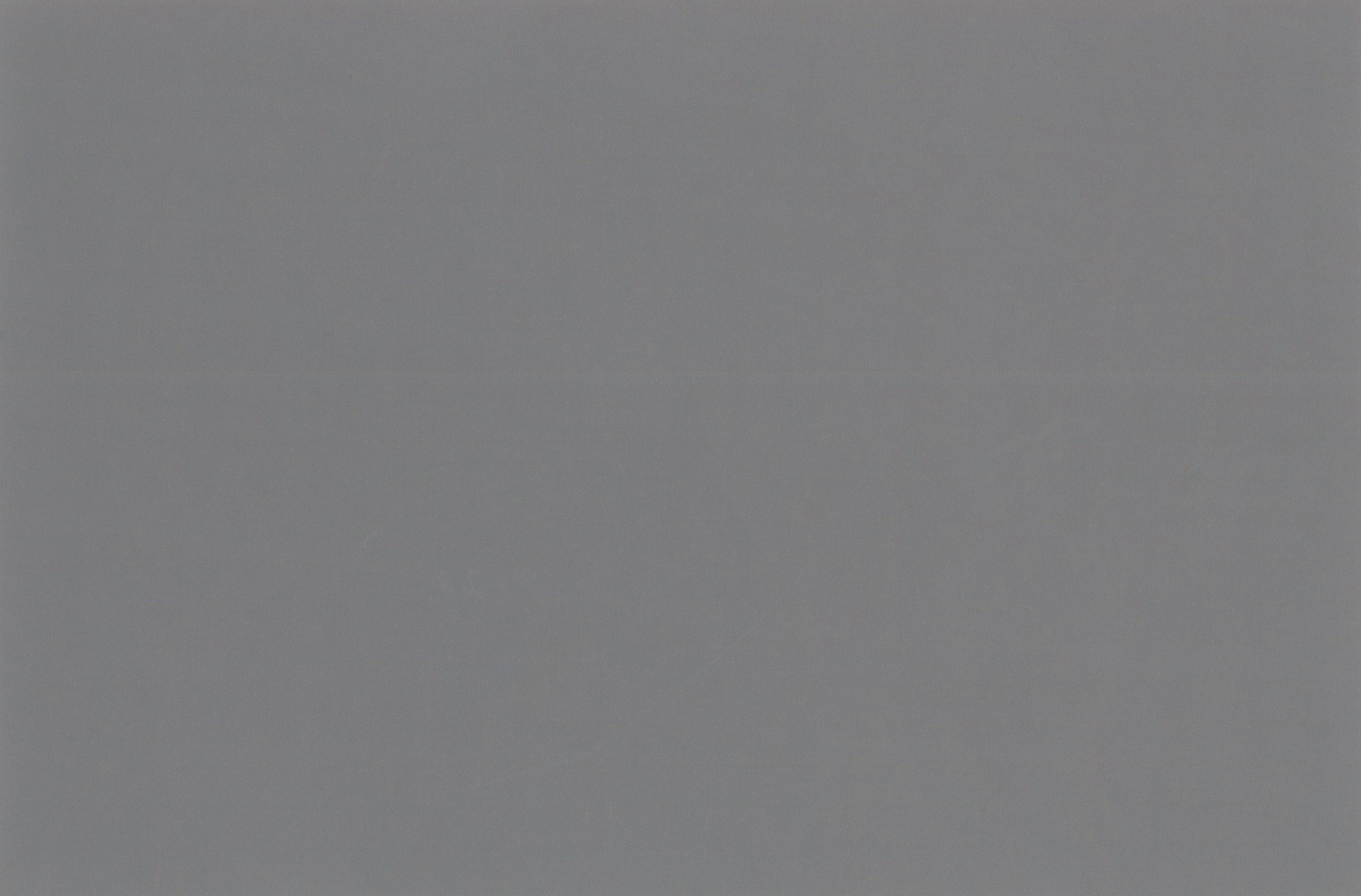

We have a Epson XL10000 scanner that has dull (out of focus) light line that runs the length of the scan. I removed the top cover and vacuumed out what I could but the line persists. I am hesitant to use forced air. I want to get to the actual sensor array.

Yes, glass is clean. To add to this it is not a sharp or in-focus line so it's not sitting on the sensor and it's not on the glass. More like a smudge. wider and lighter with a non-defined edge.
Can you post an example?
One thing that comes to mind is something somehow settling on the mirror or the lens. But it's rare for this to happen.
Hi Koraks
This is a scan of a 4x6 print. I thought something on the mirror myself, but would that not be darker and not lighter?

Thanks, I see what you mean. It's subtle, but it does appear to be colored and not monochrome and it appears to be fairly sharply delineated as well. Could be dust on the sensor alright as you initially expected, but I'm not 100% certain.

One thing is what something like dust does to the actual sensor signal, another issue is what the scanner firmware/software does with an aberrant signal. Simply put, a speck of dust can cause a signal that doesn't behave like the firmware/software expects it, causing it to be tricked into interpreting it as always illuminated. It depends on how the hardware interacts with the low-level software; this is very implementation specific and generally not covered in a tech manual.
Any idea why it would be lighter as opposed to darker?
This suggests some dirt/smudge on the calibration strip. It's a strip tat is read by the sensor at the beginning of each scan, to calibrate out the deviations from uniform response of the pixels. Don't know about the XL10000, but on my V700, that strip is on the underside/top of the top plate, just above the scanning glass. I think (IIRC) it is covered by the glass. Still on my V700, removing the top plate is easy, but separating the glass from its frame to access the calibration strip is not trivial. Hopefully you have a smudge on the bottom (top once you have removed and flipped it) of the glass, above the cal strip.
If you find there is dirt between the glass and the strip, I would suggest to overlay the strip (and glass) with a strip of smooth white paper. Something like satin or semi-matte inkjet paper. Be aware that this strip defines the white point; so strange things might happen if your inkjet paper has optical brighteners...

Great idea! While there was a spec of dust between the glass and the calibration that we removed, the light line is still present. We will look again tomorrow.
is there any scanning tape - or any negative holders for this XL which would let me scan negs well?
If there is a transparency adapter option for this scanner we do not have it.
We did clean a very small dark spec that was beneath the glass with no good effect. Calibration strip is clean.
