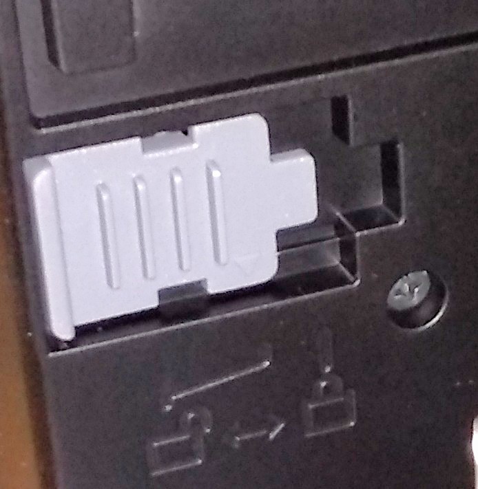

I thought that the heads were unlocked on my V850, so I called and a replacement was sent. It turned out that the heads had been locked, but the icons on the equipment was very confusing. I had switched them to the locked position and I heard banging. I hope this helps you.

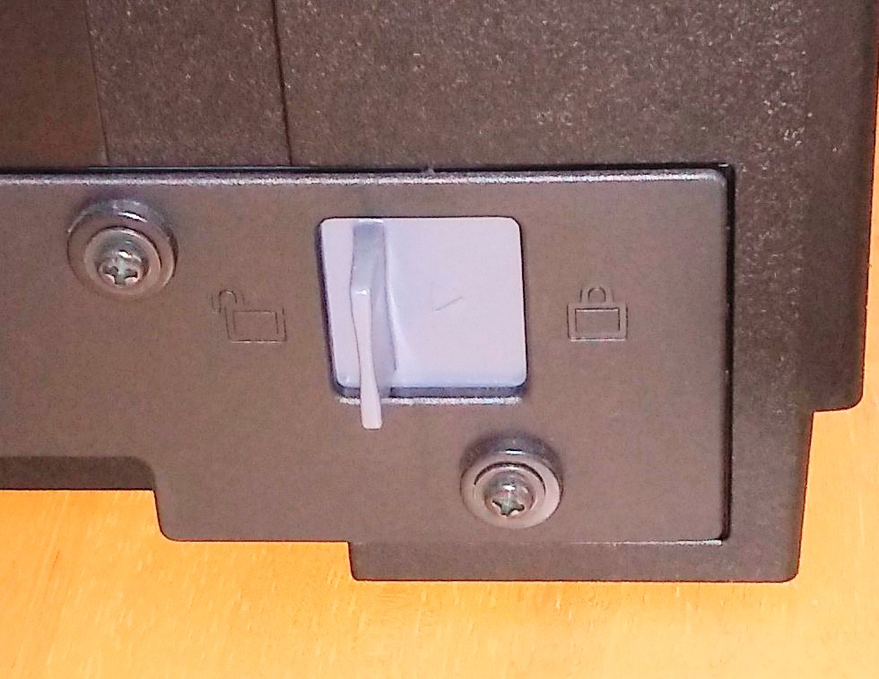

Epson V800 in unlocked position:
Thanks for extra comments. It was not a matter whether they were unlocked or not, they were. It was a used "new" unit which won't get much use for a while here for unrelated reasons, but for $450 I thought it was worth it as they seem to hold the price rather well. It was just disheartening to see heads unlocked knowing first hand what happened to that 4990 when it shipped like that. For now it is working, so fingers crossed until I get a chance to do some precision tests.
