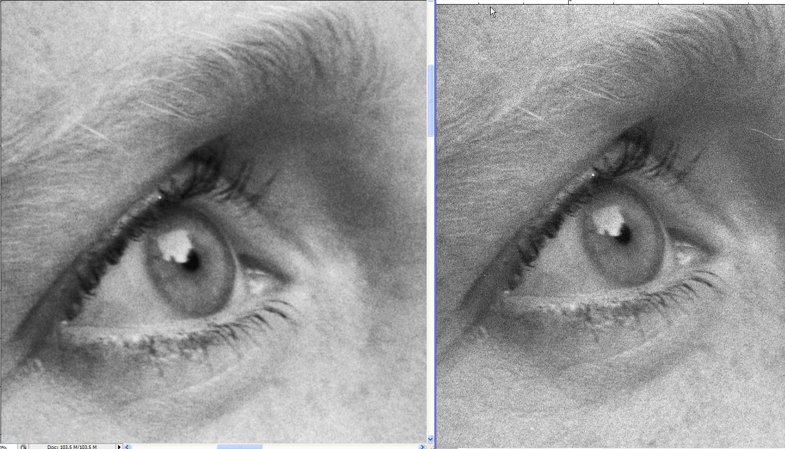

Owning both scanners, I thought I would made a comparisation. Film is ilford delta 400.
Have a look at the results: no sharpening, no lightning correction. The one on the the right is the imacon.
Epson, film scanned on 4800 dpi
Imacon on 3200 (maximum)
Film grain is visable on the imacon, the espon seems a bit blurry.

So this was film that was placed flat on the scanner glass? That's where the 4800 DPI lens focuses.
Overall, this is not surprising. It's well-documented that the Epson has about 2400 DPI of real resolution.
Thanks for the comparison.
--Greg

I am intrigued how close they are but the Imacon looks more natural even from a distance.

Is the film 35mm?
no, 120.
Both are too bad scanners
I love working with the Imacon, although it is an older scanner, I believe the detail in shadows can't be beaten.
No, in the original holder. I never read before that the focus point was on the glass.

I will do some more testing with a fuji velvia 50 4x5 later, so there won't be any grain (The film above has more than usual grain after development but I thought I would made a good test)

The Precision II is known to produce very grainy scans. The later Imacon-Hasselblad are much much better in that.

Ah, that's good to know. I will pay attention to it. So far it did't occured to me. I always read positive reviews about this scanner, so when I could pick it up in return for a bottle of whiskey I was in heaven.

no. Quit a few color positives (fuji velvia 50), where I was happy with. I can't remember any visable grain, but I will have a look at some of them later

For slides it's an acceptable scanner, I agree. For color negatives is a disaster.

For B&W film I shoot 6x6 medium format. I have often made 16 inch sq silver prints in the darkroom so I'd like to do that in an alt process like Gum or platinum.
As I said, I'm not into sharp hard prints. But, the flatbed scanners may not be up to the task. I don't either.
Hi Robert
