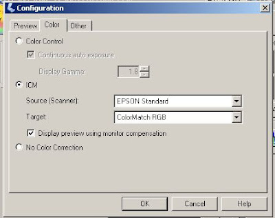

I suggest you set it to something like this:
this will take the mystery out of it as Epson scales the data values but does not actually assign the profile (especially if you are scanning into software such as photoshop)
if you don't choose an ICM you'll have to 'fish' for the right colour profile ... probably something like Epson v700 TPU or the like

I tried that, thanks :smile:
It's much darker than the actual slide. I'm scanning Velvia 50 RVP if that helps, I have read it is a denser film for the limited DR on the Epsons ...

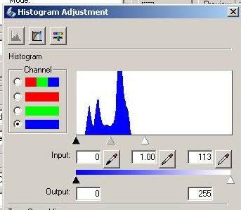

try adjusting the sliders on the histogram preview to hit the 0 line on the left slider ... for instance:
make sure the dark end is hard pegged against the left hand side (ignore the values in that diagram histogram, that is because I'm scanning negative as positive in that example).
I have found that driving the dark ends of R G and B level hard over to the left actually increases scan times and results in better dark penetration. The default position is about 10 points shy.

Can you tell me what is ColorMatch RGB? Where is it from, is that one of Adobe's default?
Every time I try ColorMatch, it goes way dark. I am on a PC so I don't use that AFAIK.
I tried changing the highlights settings - looks more of a haze but I get more details from it.
I managed to change it to auto, gamma as 2.0 and works nice instead of 1.8.

Essentially all are just colour spaces ... you must match your display with the colour profile (in colour management aware software like Photoshop) or it will look f*ck3d (unless you are working totally in sRGB). Without going into a tute on this, as long as your display software knows about profiles, and is set to open a file and display it according to the right profile (not to over ride or ignore it) then you're sweet. If your software does not (say, CorelPaint) then you're up the creek.
worse, if the image does not have the profile embedded ... you have to know or guess ... happens to me quite a bit with places scanning into their printer profile, then not embedding it ... sigh
The differences between the colour spaces have to do with gamut of the colours which can be represented within the data range of that space.
I typically use that one for my Epson simply because it doesn't happen to have many in its kit standard. On my Nikon I use Bruce RGB

I think I did use ColorMatch and it was dark in Epson preview and so was in Photoshop, I thought that Photoshop would be more color aware ....
When I opened the file, it said no profile embedded.
Will try again or maybe incorporate Epson input scanning within PS but I think it does go much darker ...
Will try other settings, maybe those profiles are just off for my scanner ....
Never used the ColorMatch in my other settings.
I know that my monitor calibrator is under as "Spyder2Express" and Photoshop and LR afaik auto senses that ....
