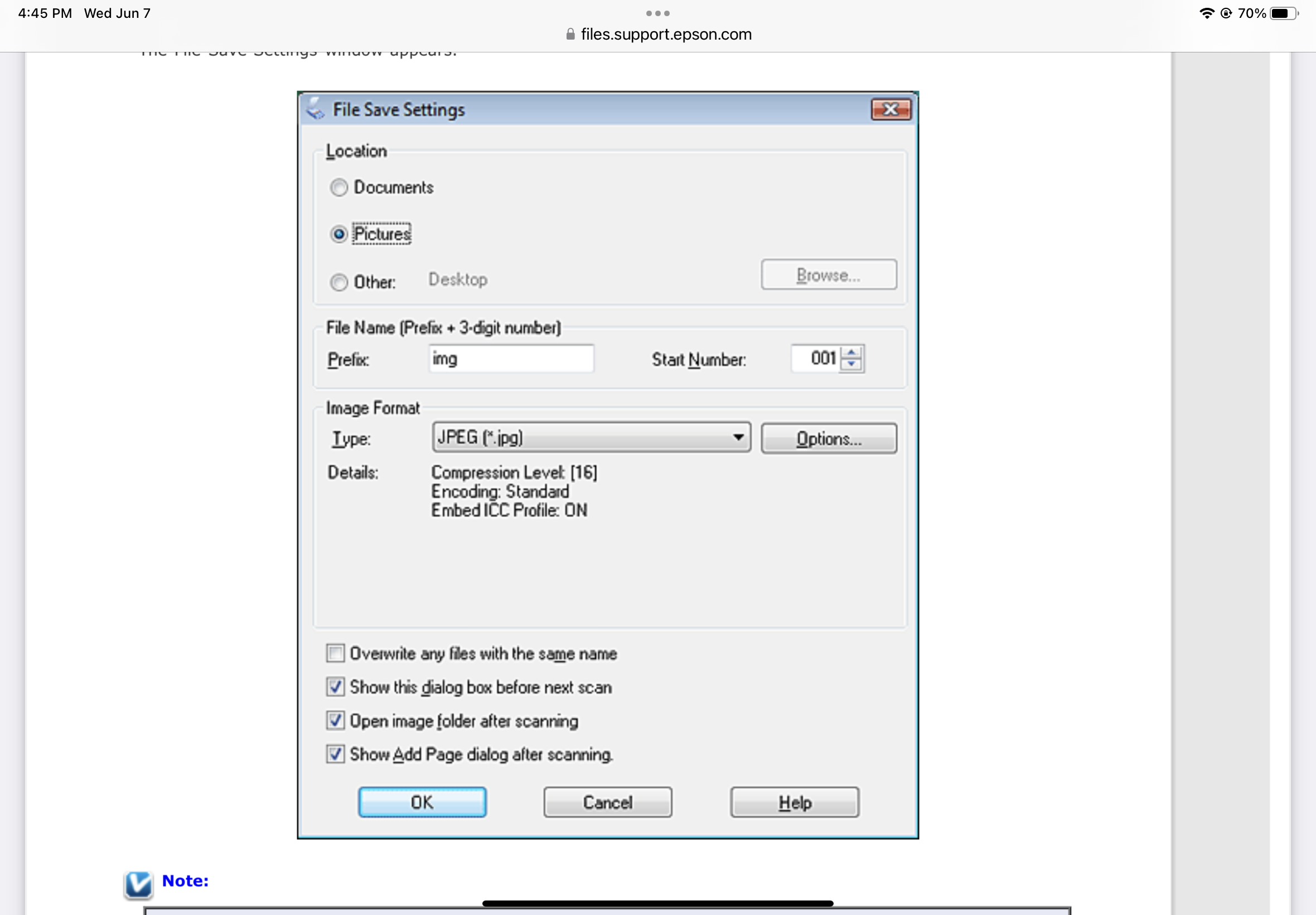

File compression can be changed in the Eason software . I think this panel is old but should be applicable. I have just had my v600 for a few months. I noticed right away that the jpg files were smaller than I expected. But seem ok.

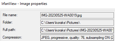

I think it does this, or can do. I don't have PS running now; only GIMP, which doesn't seem to have this function. I do have IrfanView (free), which seems to give this sort of information on JPEGs:
From a random image on my hard drive. Note quality level; this is actually the inverse of compression. Since it's an image I think I received over WhatsApp the 76 sounds plausible. It's pretty bad if it's as low as this.
File size is usually also a good indication. E.g. the image above has a resolution of 1920x1280, but it's only 183kb on my hard drive. At a high quality level it should be at least 5 times as large, I reckon.
