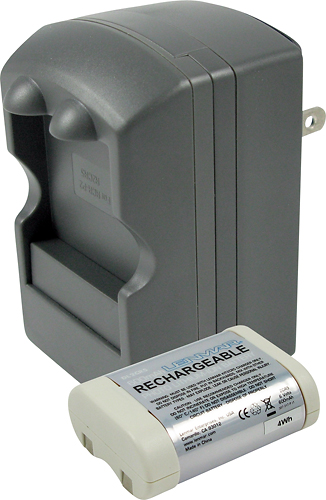

Thanks. Will this one work? Is that the right battery?

That looks like the right battery. I have a Pentax that also uses a 2CR5. I've not tried a rechargeable 2CR5 though. Mine currently has an alkaline battery in it.

Rechargeable 2CR5 (and others) have a poor reputation for use in cameras. If you want to save money get the Battery grip and good rechargeable AAs.

+1 to this. I used a rechargable 2cr5 in my eos5 and it didn't last long at all. Plus the recharger isn't that well built. For the cash outlayed on the recharge setup its actually cheaper to buy normal 2cr5's. I have both Duracell Ultras and Energiser 2cr5s and they last ages.
