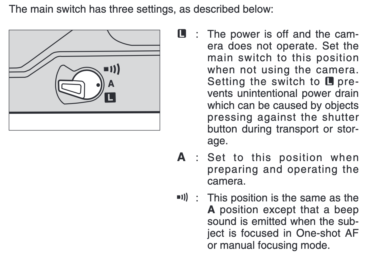

While relying on the reassuring beep of autofocus lenses assures me of accurate focus, navigating manual focus feels perpetually uncertain. Are there any strategies to surmount this challenge?
You can have the reassuring beep with manual focus lenses, see the manual how to set it up. Essentially it is an acoustical focus assist which uses AF sensors to tell you when you've achieved focus:
