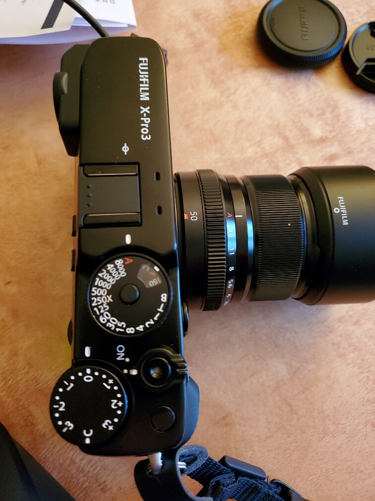

I got this today, bought a couple nice Fuji lenses 23,35,50 f2 used in mint shape. The optical finder is fun.
