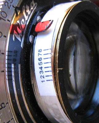

The best way to adjust the focus is to first check with a ground glass on the film plane, adjust the infinity focus, and then with film, turning the focus ring in very small steps between each shot.
I use a numbered scale with eight markings for 6x9 or twelwe markings for 6x6. After taking the test shots I develop the film and study the negatives. If shot number three is the sharpest, I turn the mark the front element so the mark I have made on the mount corresponds with number 3 on the scale, put the focusing ring on and locks it in place.
This way you take the film bulge in to account. I developed this method when I wasn’t satisfied with the results from my Zeiss Ercona II camera. I first adjusted the focus using a ground glass on the film plane. The results were better, but not enough. So I tried with this method, and was amazed by the difference. The Ercona II is now the sharpest 6x9 camera I have.
