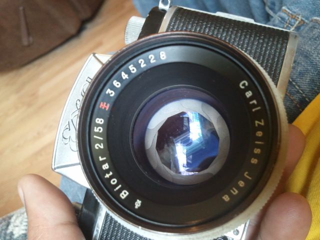

Enlight me on this Zeiss Jena Coating Symbol

Enlight me on this Zeiss Jena Coating Symbol, its not T or F, please see attachment.

It's a "T" with a line in the middle and a line at the bottom. The legend I heard was that Zeiss Oberkochen wouldn't let Jena use the "T" and they modified existing lenses this way so they could be sold. As I said, a legend; I've no idea if it's true but there you go.

That'd make sense, I've heard about similar stories just never seen a marking like this one before.
There seems to be a slight assymmetry in that "striped" T. That would indicate a re-engraving.
My 1953/4 CZJ 150mm f4.5 T Tessar has the T marking but that was made at the point the separate East and West German parts of Zeiss had been forced to cease co-operation and legal wrangling over the trade names and trade marks started.
CZJ enses sold in Europe could have markings that were not allowed in the US, this is an Exacta lens and all Exactas sold in the US has to state they were made in the Soviet Zone, I can't remember the exact wordint but I have an Exacta WLF that "USSR Occupied"
E Von Hoegh's anecdote is probably right as it coincides with these US markings.

So best guess it was earlier on with all the arguments over the right to the name because this one still only says Germany instead of occupied etc, i have ones that says USSR Occupied.

The more and more I looked at it, the bottom two lines looks a little off. Probably was a T and they re striped it later on then.
