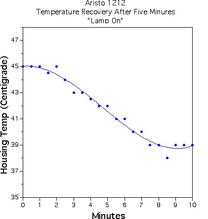

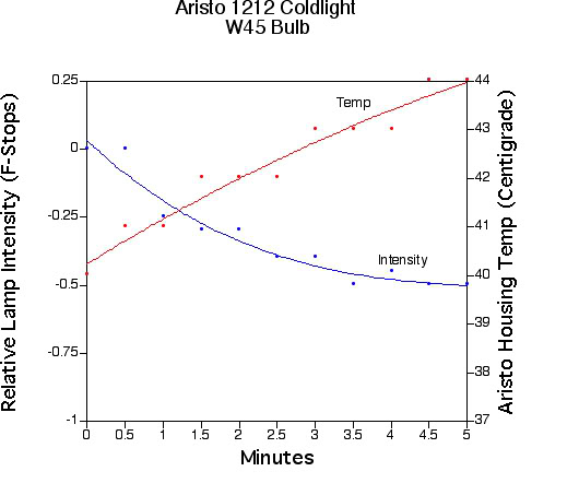

Since I have a fluorescent light source that has no regulator, I've not been able to duplicate one print next to the following one.
Bill, I worked with a similar primitive setup and was eventually able to establish good repeatability. I posted about it back in 2007, I believe. Did you ever see that? The workaround was to only start a printing sequence or test strip when the lamphouse was at 40C. The second point was to not alter the sequential order of dodging and burning steps.
