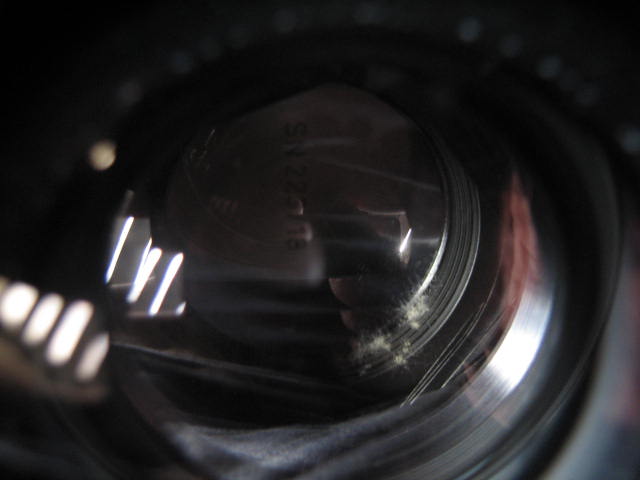

My friend gave me the Nikon today and it is a 75mm not 80mm like i thought. I also have a Componon-S 150mm that has some fungus and i would like to save this lens. Can i clean it? The fungus is around the sides of the rear element and the threads... The glass looks good on it. Here is a photo of the 150 that i believe i can save. How can i clean it?
Inside or out, it's just a simple retaining ring & a little ammonia on a Q-tip.
Don't drop it.
Robert Hale
Aug 23, 2006
24
ULarge Format
HI J Rollinger and John Koehrer.
A 50/50 mix of Hydrogen peroxide ( 6% hair bleach ) and cloudy or plain ammonia gives a much more active clean.
If this mix does not clean the glass then you can pretty much bet the glass has been etched and can’t be cleaned.
