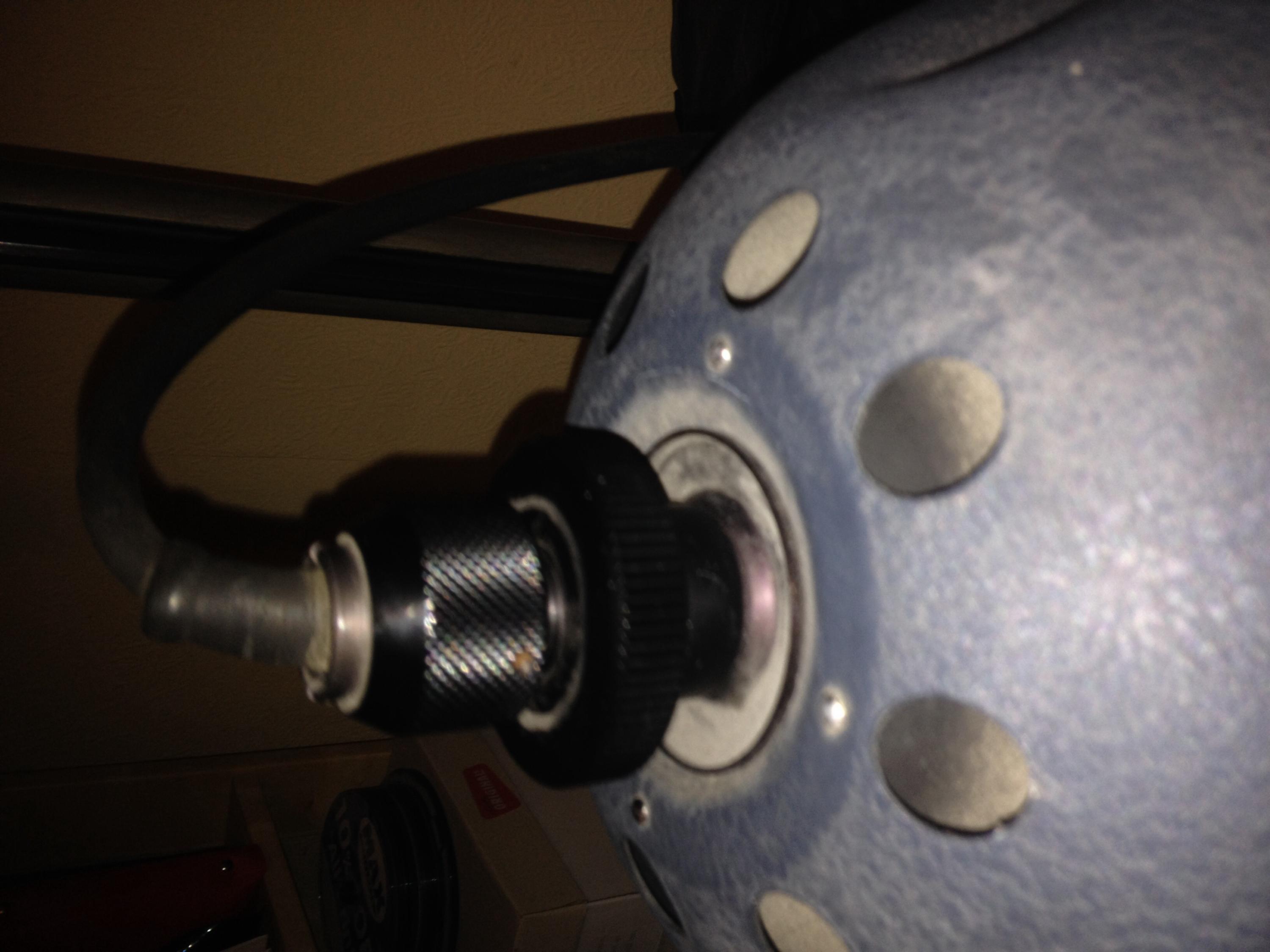

Here is a picture of the head. I wonder if I need to loosen the small screw in the knurled knob?

You're right it's an f4.5, I've had two the first was used in a commercial darkroom and became scratched (the glass is relatively soft). I picked up a second more recently.
Yes loosen the small screws it should all come apart easily.

There are some very small screws like you get on glasses where they hinge. I think these might hold the knob in place as it doesn't budge.
Is there something inside the head that screws onto the assembly and holds it tight? If you take the bulb out, something around the base of it that unscrews?
Not that I can see, it loosens enough to adjust the bulb centering but not enough to pull it through. There is a brass sleeve that screws in and hold s the bulb but that's it
Sent from my Nexus 7 using Tapatalk 4
Hmm ... maybe you could splice the old cable with the new cable and use heat shrinks and electrical tape. Then you don't have to remove the bulb assembly. That may be what I did. I wish I could remember.

I would be open to that idea if the wiring wasn't in such a bad condition. When testing there was a loud crack and a flash where the inline switch is situated. Closer inspection revealed the outer sleeve has deteriorated exposing the inner cables which shorted.
