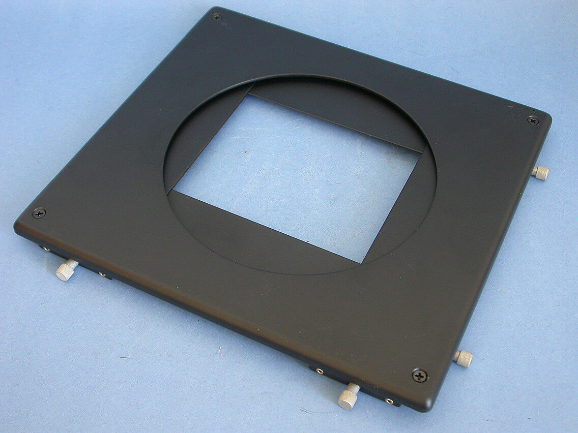

One issue that I have had is the placement of the negative in the holder and using the negative masking in the V35. Is there a trick to getting this right? It is near impossible to get the negative perfectly centre in the negative holder. Ànd the V35 masks don't seem to work very well - the screws seem to have some give so the darkened area moves if I just bump them; they don't seem to be parallel to the edges; there isn't a sharp light to dark, but almost a soft edge with light falling off (or at least it seems that way when I am adjusting the image).
Am I doing something wrong? Is there a trick I am missing? So I have faulty equipment?

But if all the masking in the head is supposed to do is get rid of most of the light around the exposed negative, and the proper framing is done on the easel, then it is probably not a major issue.
Yep - the easel is where you set the framing.
The masking allows you to minimize extraneous flare, and permits you to enlarge smaller/unusual film formats. As it is at a different plane than the negative, you wouldn't be able to use it for crisp borders anyways.
And don't feel bad. If you have been trying to set the framing with the negative holder masks, there is no surprise that you felt frustrated!

... I was trying to get the mask to come perfectly to the edge of the exposed part of the negative on all four sides by turning the four screw knobs, but had the above described problems.
Either case, I think there is something wrong with two of the screw knobs. Two of them are very secure and only move in and out if I turn them. The other two have quite a bit of give. Enough to make a difference in terms of the area of the negative they cover. And masking area definitely does not form a perfect rectangle. Maybe it doesn't matter if I am supposed to mask using the board rather than the enlarger itself.
The mask blades will always be out of focus, so don't depend on them for creating the border around your prints if you want sharp borders. Set the enlarger's making blades so there is a rim of light around the negative and then bring the paper easel blades a few millimeters into the image area. In many cases this duplicates the less-than-100% framing of many 35mm SLR cameras.
