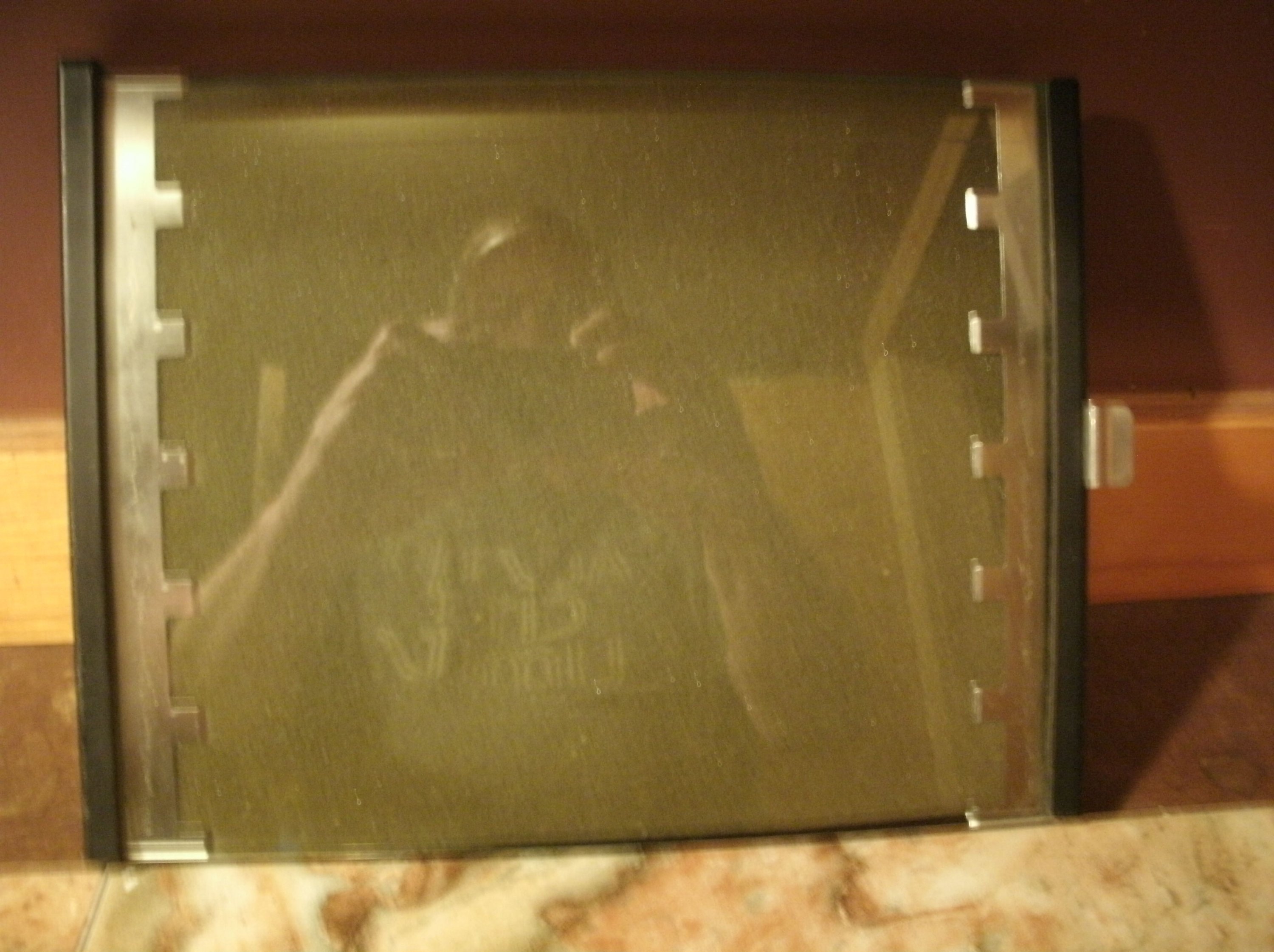

I just sold this a few weeks ago, look for a similar model. 35mm contact proof printing frame holds 6 strips of six negatives over an 8x10 sheet of printing paper.

8x10 Format
How does that enlarge the negatives? Doesn't that simply produce contact prints the same size as the negatives Thanks
