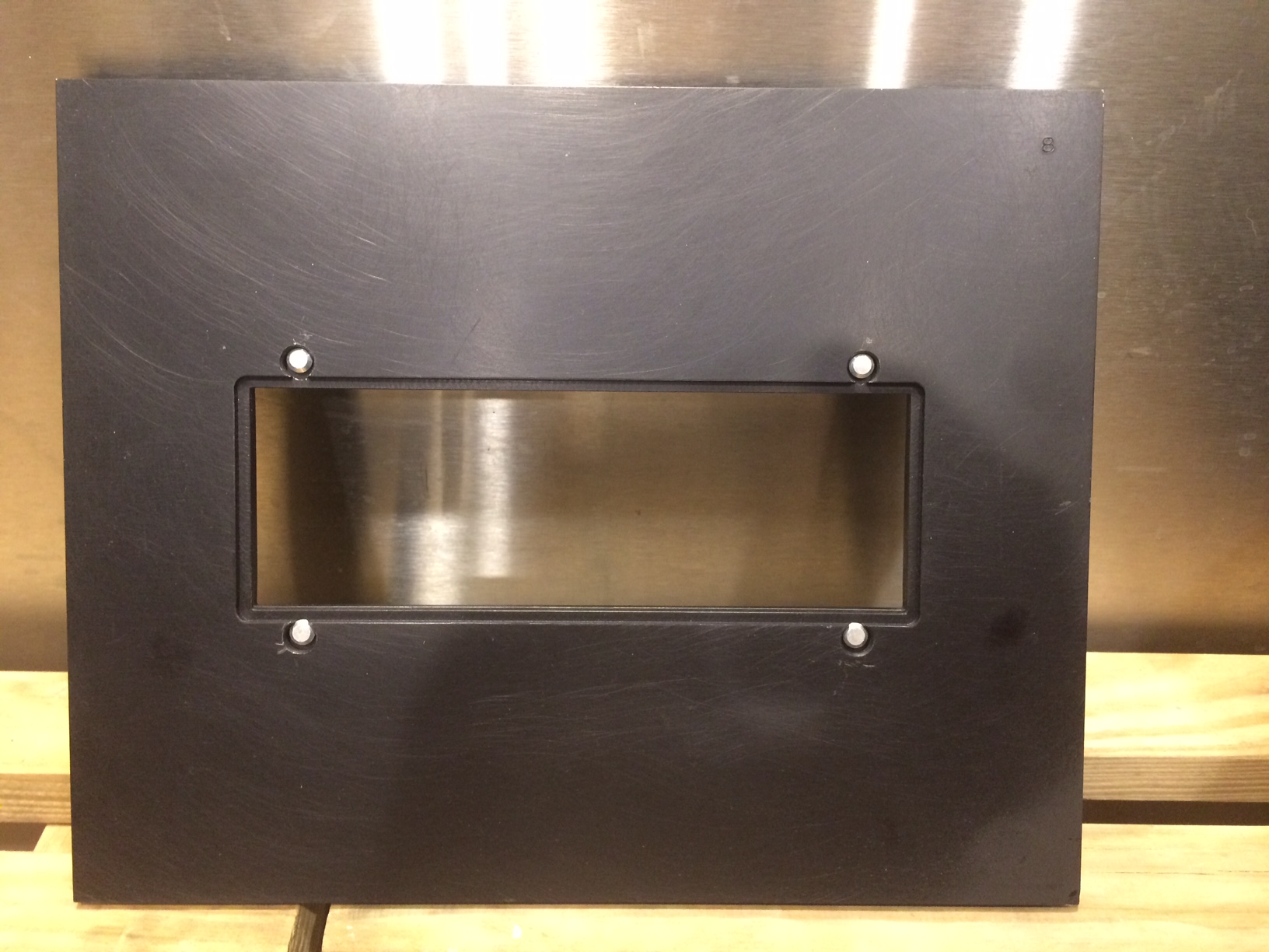

When and if you can find one and if it has all the "parts"! Here is the 6 x 17 carrier for my DeVere 5108. L
