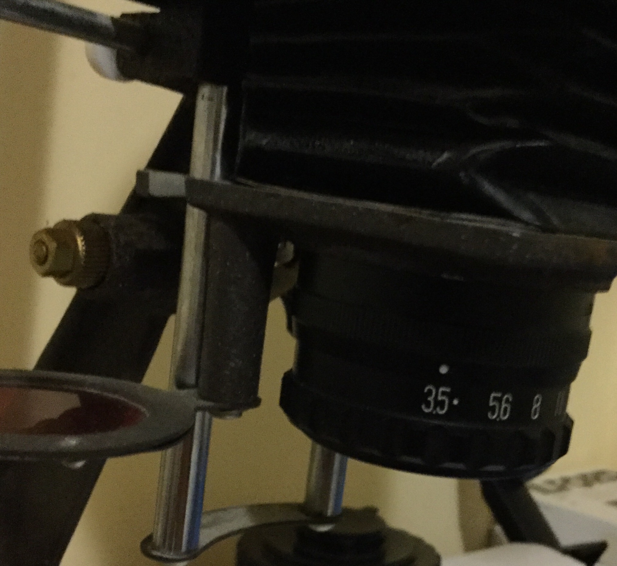

I have an enlarger without a filter drawer. In this case, how would I use the filters?

But here's my concern. The bracket might be blocked by the thing that screws onto the red filter.

Can you remove the thing that screws onto the red filter? You don't need it. The kit Ian linked to comes with a red filter, if you like using one. Honestly, I haven't used the red filter in decades.

Ok but the problem is the thing where the red filter screws onto is too short and will not go under the lens if the lens is too long.

You just get a longer bolt and use three nuts: one nut to fix the bolt's end into the opening. And the other two nuts you position lower with in between them a filter holder. Look at a metal Beseler 23 filter holder or any other brand. All it will take is to drill a hole in it's arm
