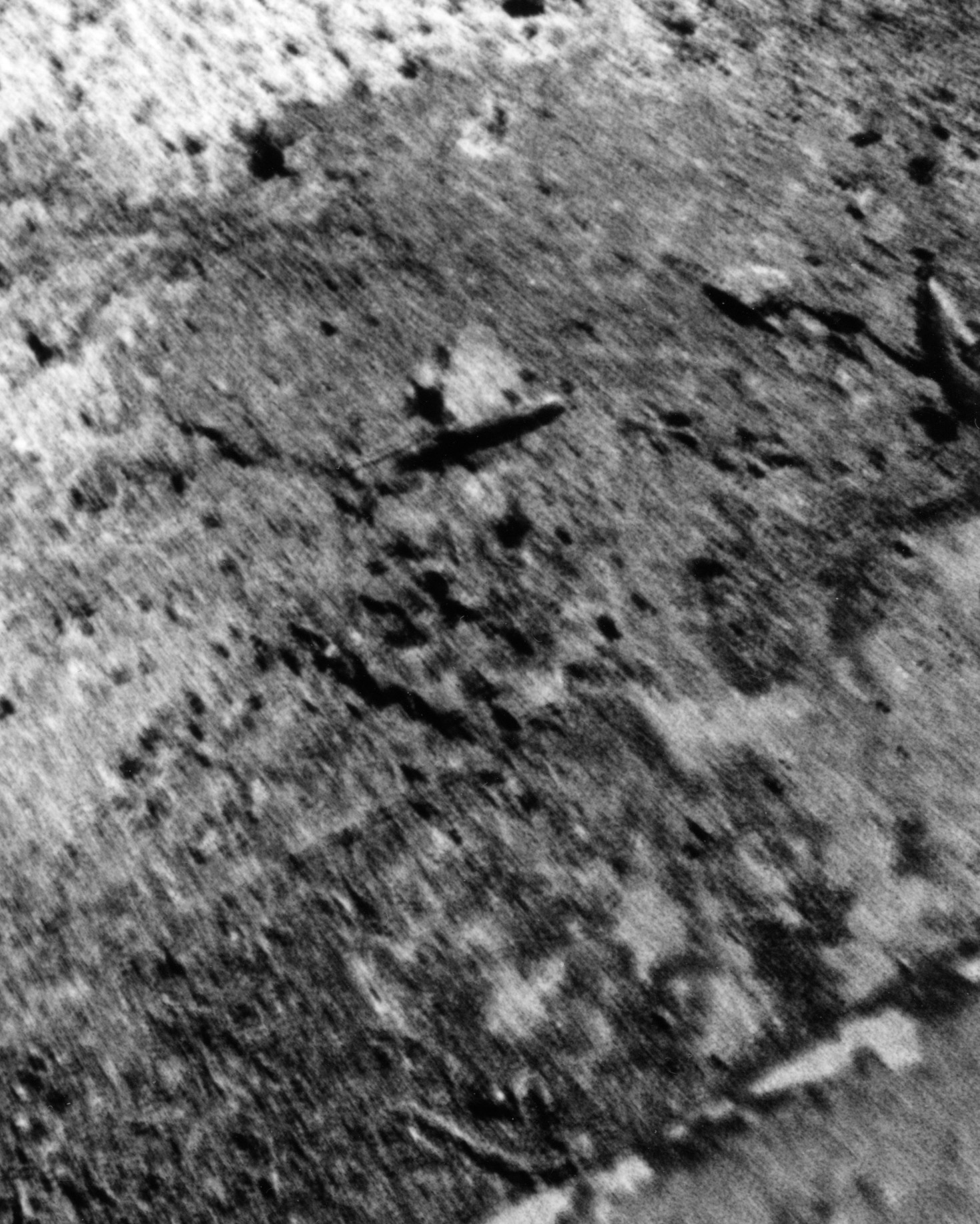

I am having issues with the stability of my enlarger. It is an Omega D5XL, mounted to the wall and braced at the top. Sometimes I get noticeable blur in my prints from the head somehow moving. The enlarger and base table feel quite stable. I see this happening at higher magnifications mostly--enlarger head about 50 inches above the baseboard. I initially thought it was being caused while changing filters above the condenser during split-grade printing and I was ready to install a below the lens set-up, but I see the same thing happening using a single grade filter. I have attached a scan of a print detail to illustrate.

You may be having floor vibrations being transmitted to the frame somehow. Another possibilty is film pop from warming up during the exposure. If this is a suspect a piece of heat absorbing glass over the negative stage will help. Another is to allow the neg to warm up enough before the exposure to pop it before the paper is placed.

There may be vibrations from the floor above to the ceiling or wall vibrations from above or below. I had an Omega 5DXL sitting on a heavy work bench and I have never had vibration problems.

I don't think it's the floor--the darkroom is in the garage built on a concrete slab. However, the enlarger is bolted to an interior wall.

Are the focus controls or the head elevation controls slipping?

If your head is braced and the bottom is secure, this is an obvious possibility negative pop... also the negative stage or lens stage on some enlargers can slip but my money is on neg poppiing..Using a glass carrier requires

Sorry to hear about your problem. One way to see it is to raise your enlarger fairly high and use your grain focuser to look at the grain. If your film grain jiggles, then you have to find the source of your vibration. Could be coming from the wall or the floor. You can first try to remove the wall brace if it doesn't compromise your safety then check again.

Could you tell (or show) us how it is "braced" at the top. I used to have a D5XL. Great machine, but it vibrated like a huge tuning fork until I used two cables with turn buckles to apply enough tension.

It looks like your enlarger is on a cement floor which is a good thing. I'm guessing your vibration might be from your wall brace. IF it's not a danger, try disconnecting it and see if it stabilizes your enlarger.

I'm not sure how you determine that it's vibration as opposed to other causes. But, given that, what is the material, shape, and size of the 2 diagonal braces? I can't make it out from the photo.
