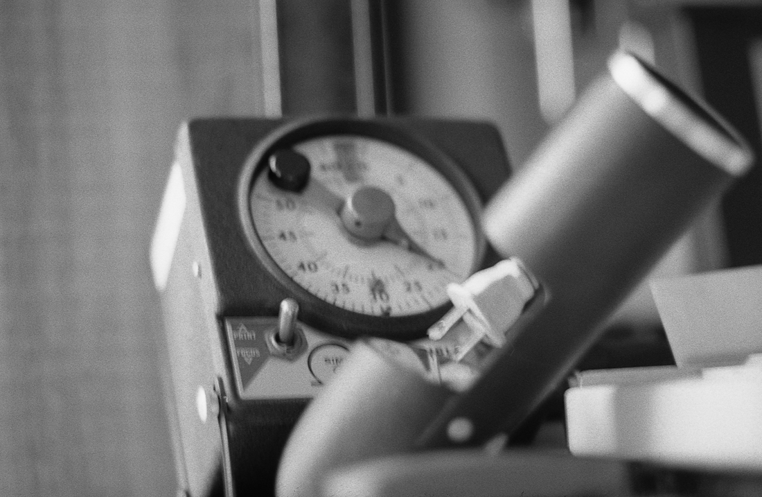

I'm glad that Martin mentioned the metronome, as Ansel Adams used one of those. His stuff looks pretty good. I don't do small enlargements, so I use an old Simmon Omega Audible Repeating Timer (see blurry photo below), and it works well enough for me. I have a native distrust and dislike for all things digital, and/or electronically complicated. Of course, I also wear a wind up watch and have a TV antenna, so what do I know? The watch keeps excellent time. About every month it gains a few minutes. My TV and computer monitor are CRT too. The image quality is better.
