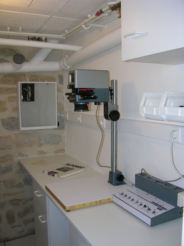

I use a electronic timer built by a buddy in 1970. :whistling: It is somewhat cumbersome but works fine... :laugh:
