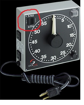

Check that you didn't accidentally switch the switch on the Gralab that switches between the enlarger and safelight outlets.

Matt, there is no switch on the Gralab that switches between the enlarger and safelight outlets
It is the switch on the top left of the face (as seen here):
Oh got it Matt, since I don't plug my safelights into the timer, I think of that switch as the one that switches bewteen Focus and Timer. I've tried every possible combination of focus and timer and on and off and, no matter what, I can't get the enlarger to light when plugged into the timer, the old one or the new one. Thanks again.
