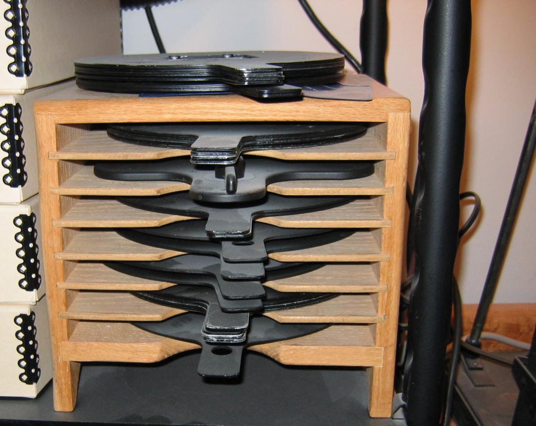

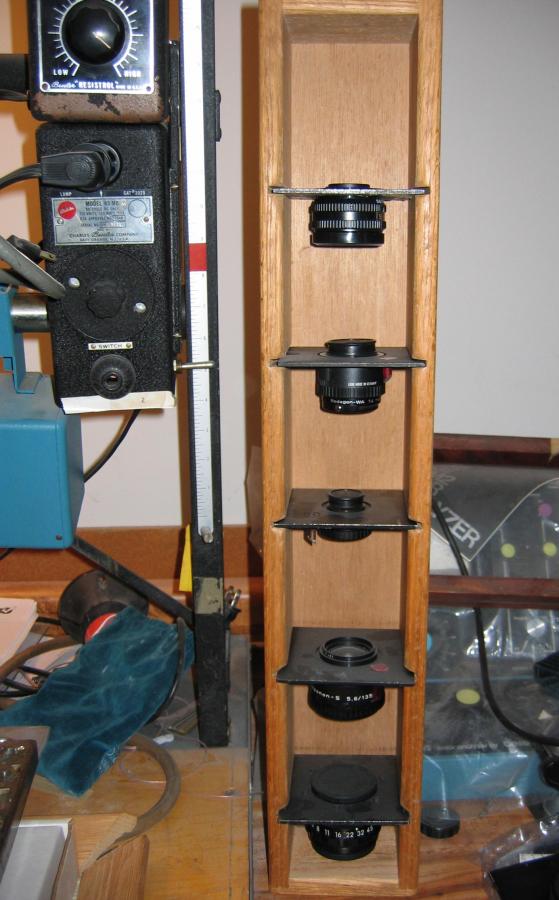

also, many , many years ago i had a custom made wooden rack made for my lens boards with the lens in place. the boards slide in a slot on each side of the boards and has worked out just fine. in fact i also had a similar device made for negative carriers.
both items have made keeping things better organized for me in the darkroom.

sure, if i can figure out how to do so
ok, here they are, ignore the dust. the darkroom is the next room to get remodeled.
