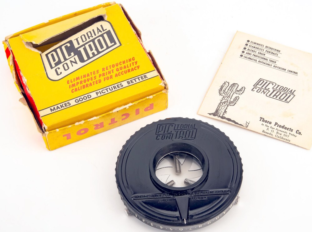

Patrick Robert James
Jul 31, 2012
3,417
There was also a Pictrol I think it was called that went below the lens in the darkroom. It kind of looked like shutter blades that extended into the image. The blades were just clear plexi IIRC. I had one at one point but never used it. I sold it to someone who was well known for that in the darkroom.
