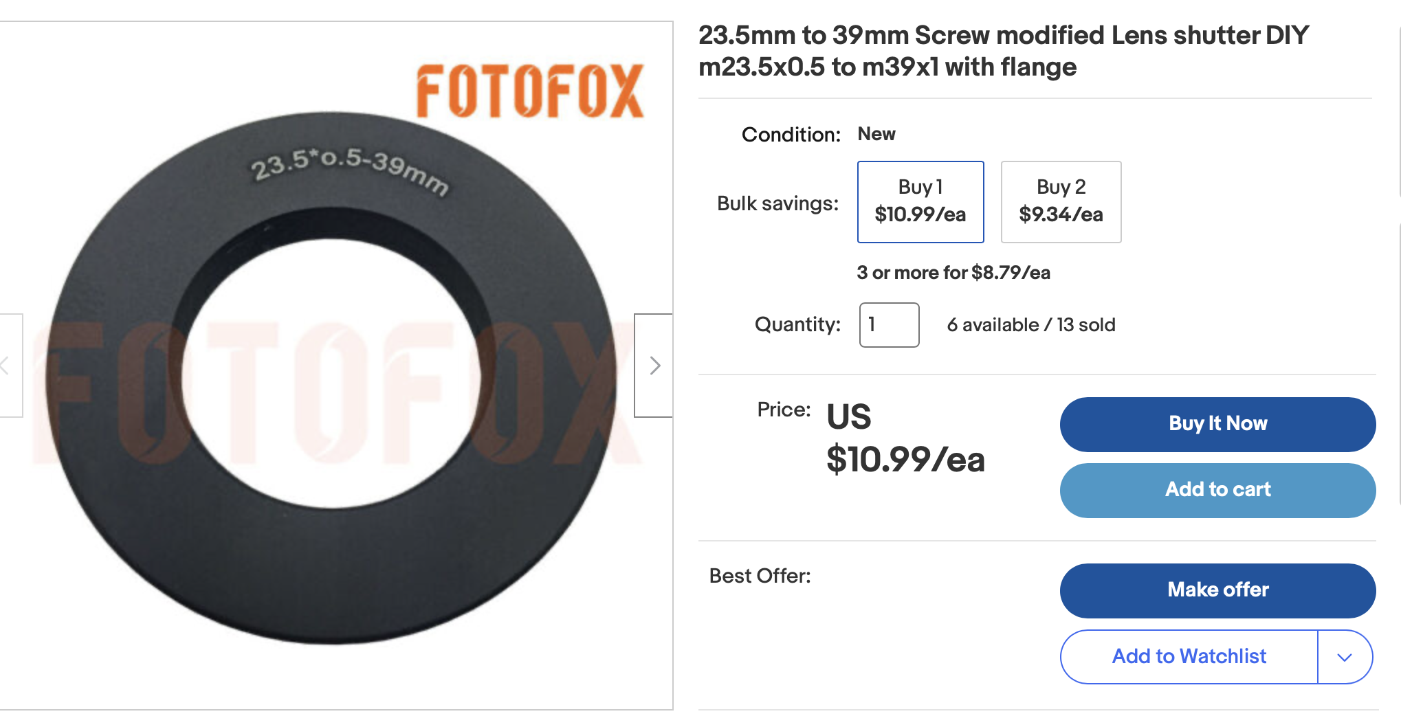

I have a Meopta Anaret f4.5 80mm lens (it has a roughly 23mm thread mount)
There is a very high likelihood that that lens has a 25mm thread mount.
@inthedark. Following this site:
your lens would have a 23.5 mm thread (what did they think??).
Assuming your LPL enlarger has a 39mm standard hole/thread, you need a 23.5 --> 39 adapter. Contact this guy, who delivers good quality for very reasonable price. Explain to him precisely what you need; is the hole on the enlarger side threaded or plain? do you also need a 39mm retaining nut?
Thank you for the reply.
I am not sure whether the hole for the lens board on the enlarger has a thread, I haven't had a chance to get a thorough look at it since it stays in the darkroom at school and my photography teacher gets weird about inspecting the enlarger. Judging off of other lens boards that I have found online for this enlarger, as well as the instruction manual I found the lens board itself is held in with a single retaining screw, if that is what you were asking. As for the retaining nut, there is a small amount of smooth space either side of the thread on the lens? I am unsure whether that is helpful. It it odd that they would make such an unusual size mount- at least to my understanding of these things.
