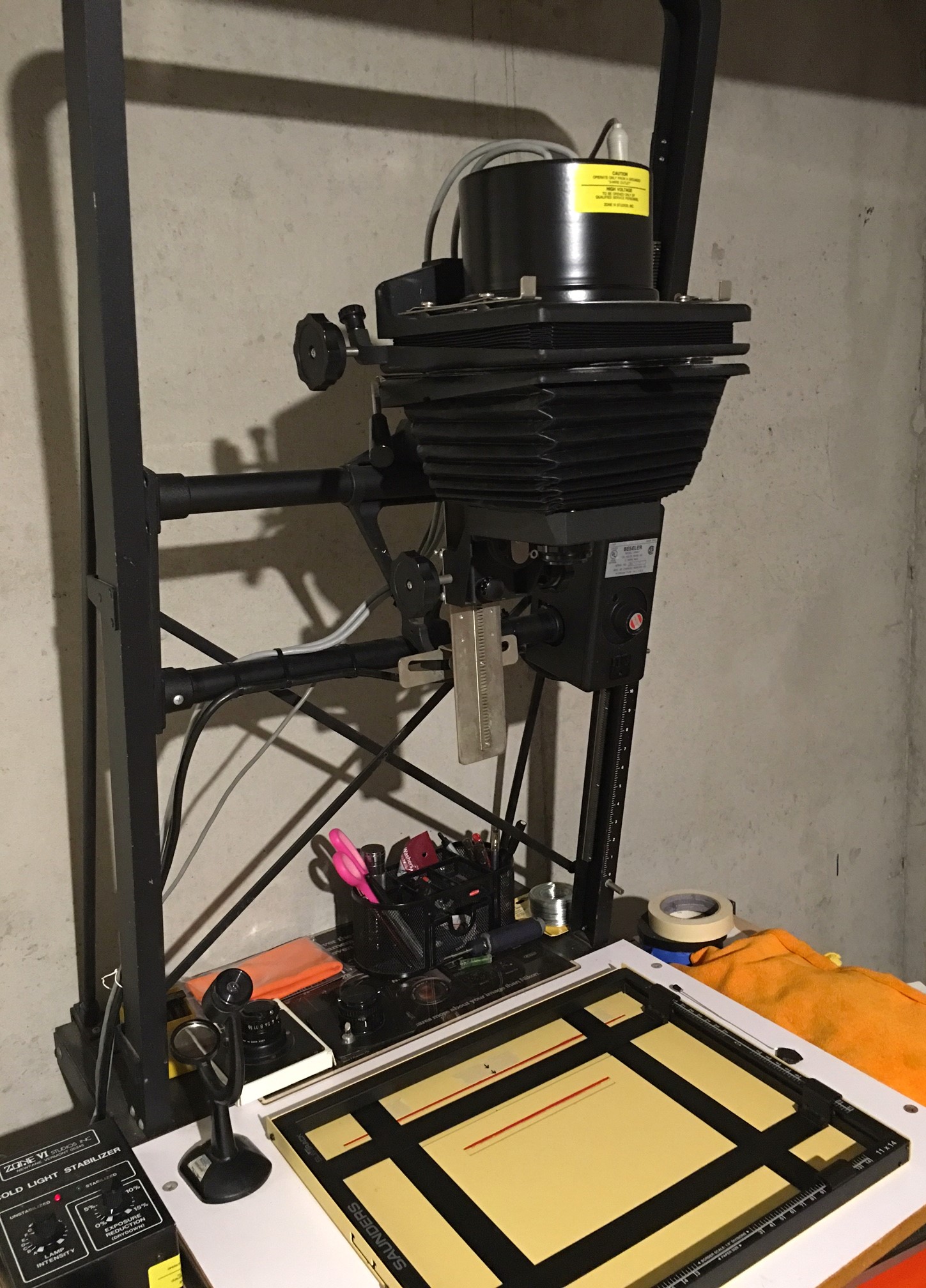

To the point about coverage of light from your Aristo cold light - how your cold light should sit in the upper bellows - here's how mine is set up, which is a Zone VI but the setup is the same.
The bellows should be all the way compressed so it is as close as possible to the negative holder. Does your setup look like this? If not it should be to be setup correctly, regardless of the negative type.

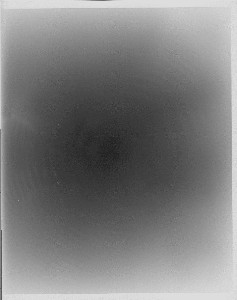

Until you get it figured out, everything is suspect. I'd not call Aristo illumination even. This is a print from my former 10x10" Aristo head with no negative, showing the hotspot in the middle.
When I got home tonight I checked and the upper bellows was not fully compressed. So I ran the knob all the way up, and tomorrow or Wednesday I'll be printing a little more and we'll see what happens.
