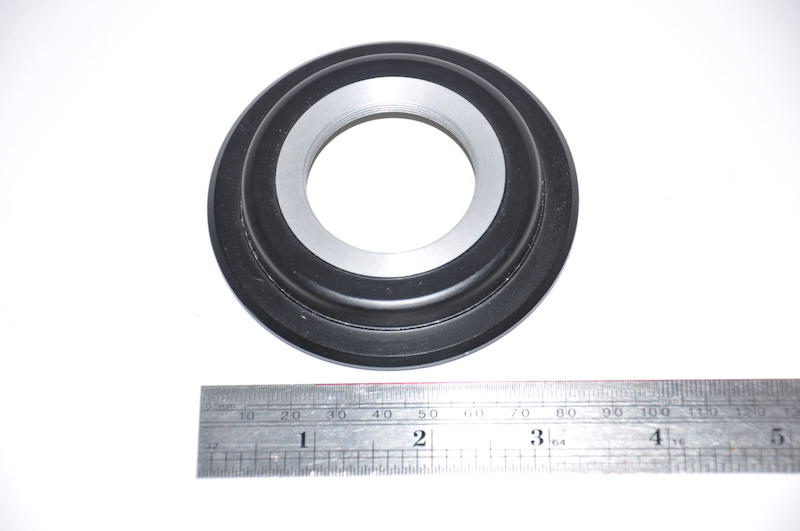

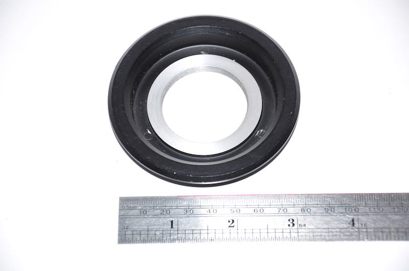

I recently got a job lot that included 2 enlarger lenses mounted on circular lens boards. I thought these were Durst fit (they have the same chamfered disc design) but it seems they are smaller at just under 60mm diameter. Does anyone know which enlarger these would fit?
