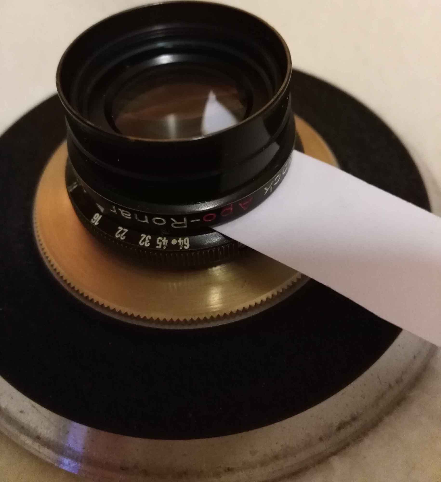

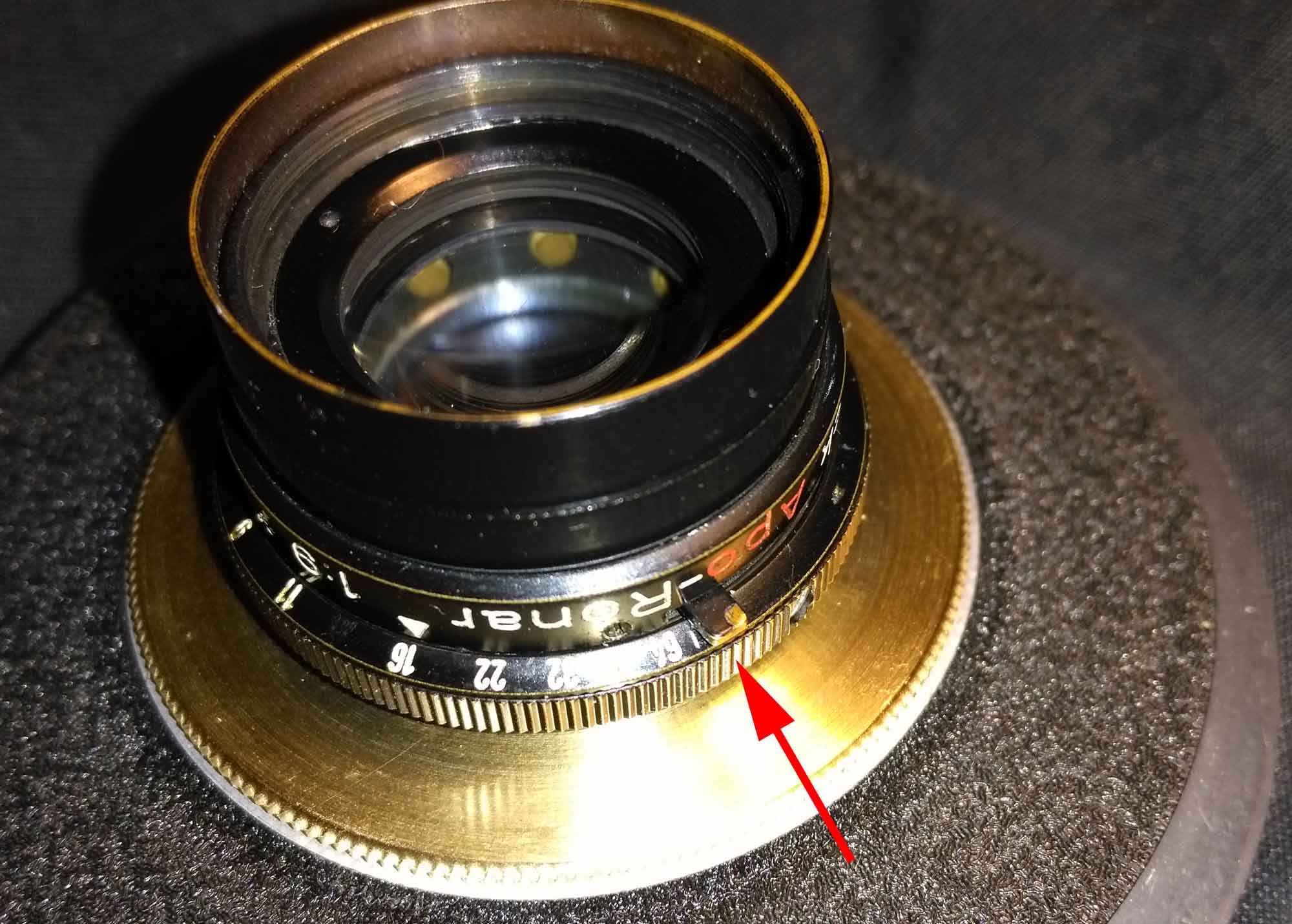

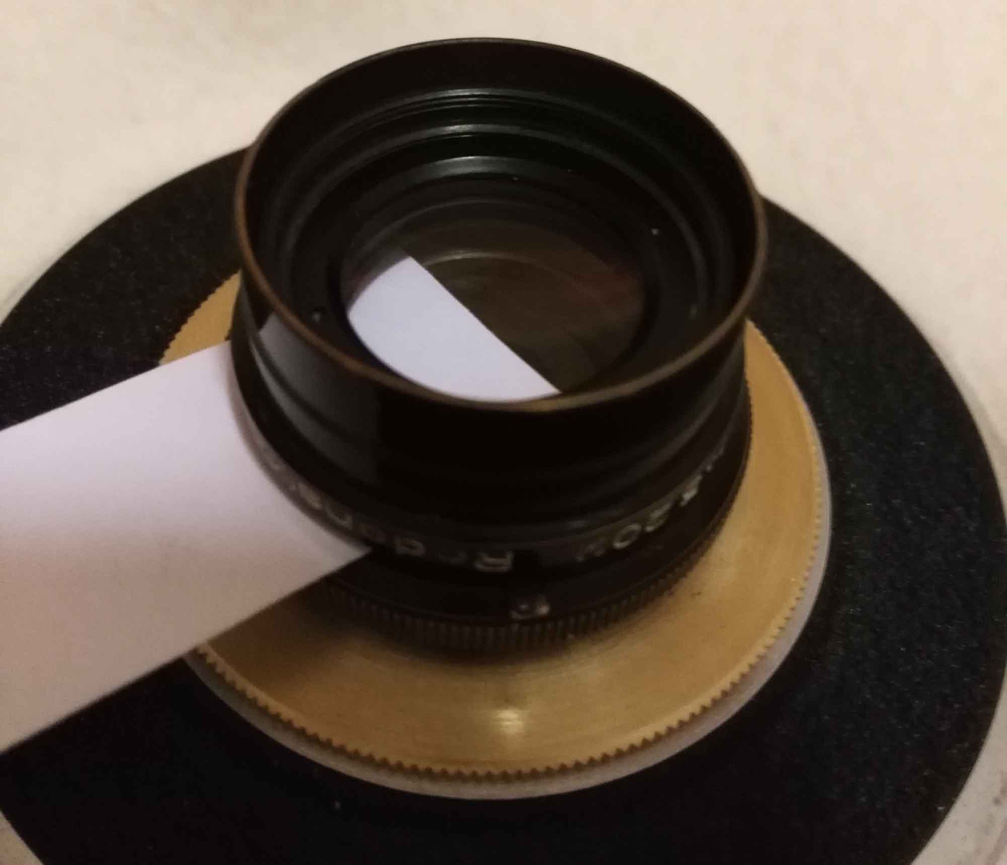

I think you are confusing the Apo-Ronar and the Rogonar-SC. The Rogonar-SC has a filter slit which allows the insertation of special filters into the lens.
No I’m referring to the process lens apo-ronar. They are equipped with a slit for filters if they are barrel-mounted. (I guess the shutter mounted Apo-ronars don’t have this feature). But a Rogonar-SC might be another option.
Jan 9, 2011
154
Kehl/Strasbo
Sounds very interesting, I have never seen an Apo-Ronar with a filter slit. Would you mind sharing a picture with us?
Here are some pictures of my 150mm ronar. The slit is difficult to see. I’ve inserted a piece of paper to actually show the slit. There is a small lever which opens the slit. (red arrow). You find sometimes the longer wavelength of the ronars with the filters on the big auction site.
For my lens I still have to make some filter holder.
BTW: the shining brass thing under the lens is the adapter for M39.

Apr 14, 2016
814
Bavaria, Germany
Thank you very much for sharing, very interesting!
