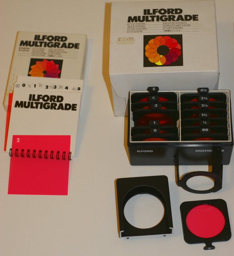

not sure if you can help me as i have bought and received Ilford Multigrade Filter Set, 8.9cm, Below Lens filter set but i cant get it to fit my lens
Unless I'm mistaken, the 8.9cm filters are just sheets of gels. The "under lens" kit consists of a set of gels 52mm diameter mounted in plastic frames 63mm square (dimensions approximate). See attached image. Left side is the 8.9cm gels, right side is the under-lens kit.
