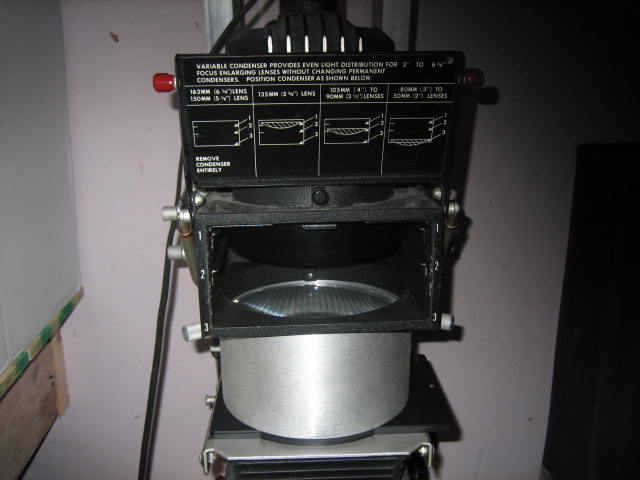

Hi, the concept is: the farther the lens is away from the negative, the closer the image will focus. Therefore there are different mounting cones/boards for the lens to attach to the enlarger. So, is the mounting board that the 135mm lens attached to cone shaped or a flat one?

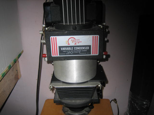

Everyone, Im very sorry for not having knowledge on this subject and not understanding responces. Here are 2 shots of my enlarger. Also sorry to post digital images of the enlarger but i didnt want to wait to develop a roll and scan it.

Its flat. When i received the enlarger the person gave my 3 Fuji and Nikkor lenses and told all i have to do is use the 50 for 35mm, 80 for 120 and 135 lens for large format. I guess there was more i needed to know than he told me.

Yes, as you found out, you need the cone for the 135mm, or it won't focus close enough. You can look for a 2.5 inch cone on ebay if you do a search on "omega cone" or something like that. Or put a wtb (wanted to buy) ad here on the apug classifieds.

Everyone! Thank you for your help with my issue!! I understand what you are saying now. If i could stretch the bellows a bit more it would be in foucs so the cone is the issue. THANK YOU EVERYONE !!!!!!!!!!!!!!!!!!!!
