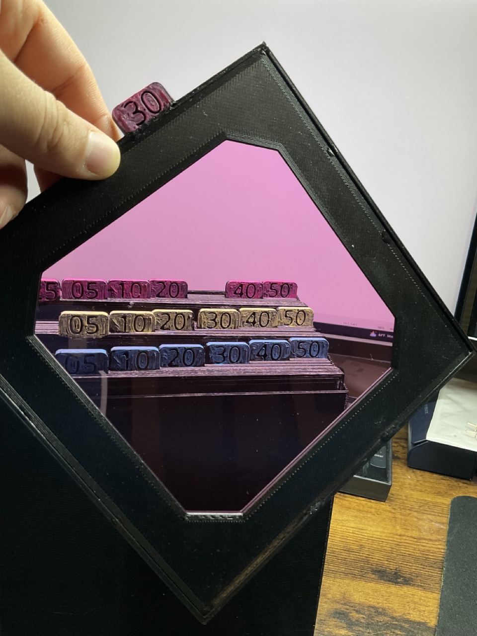

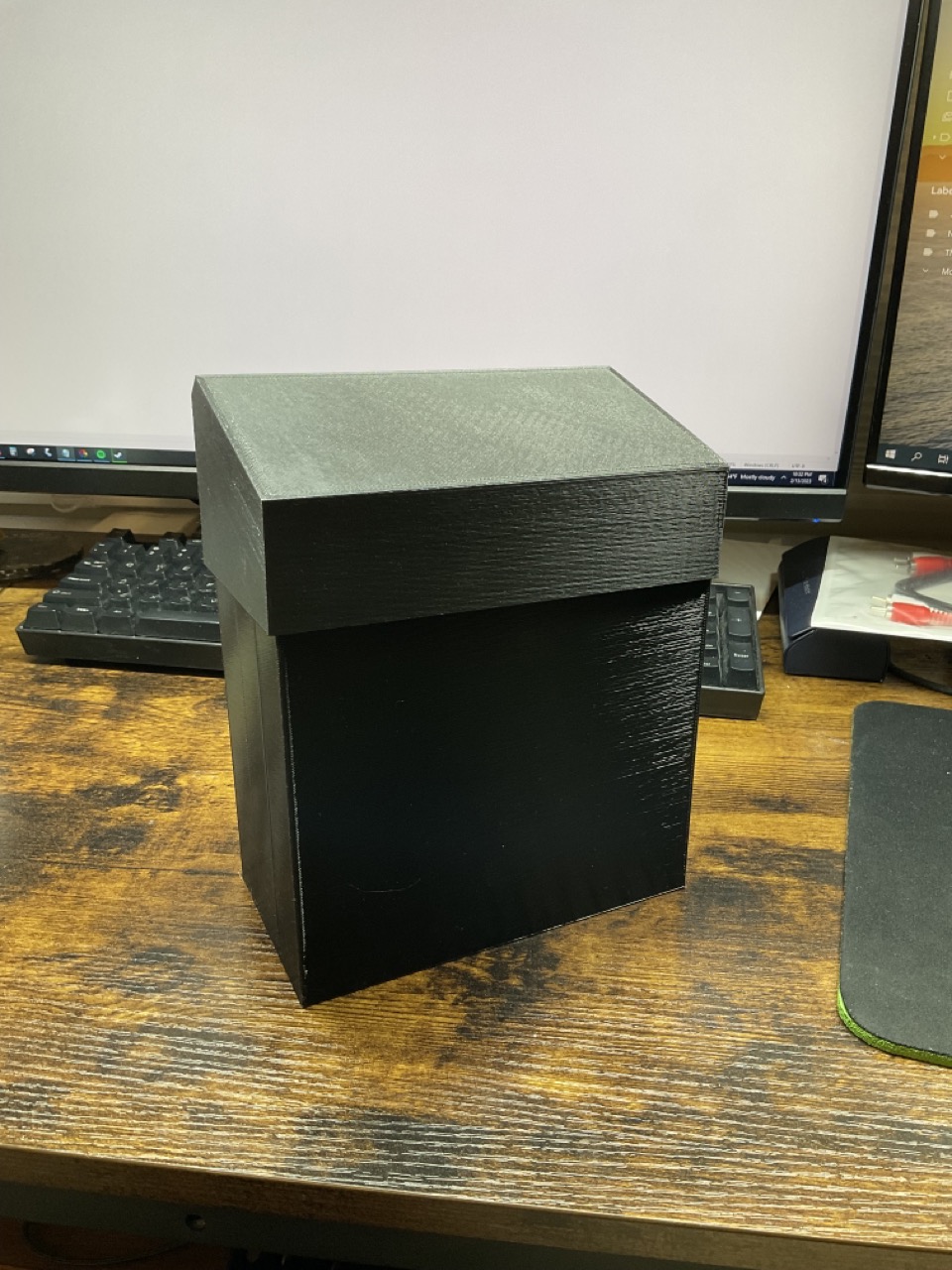

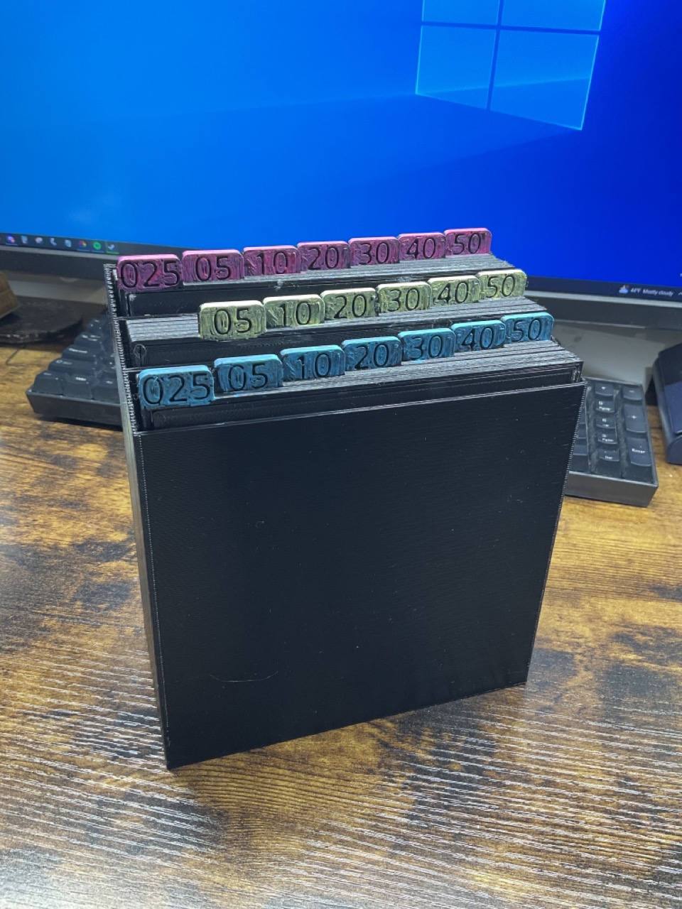

Update: here is my new filter organizer setup. Should work perfectly.
