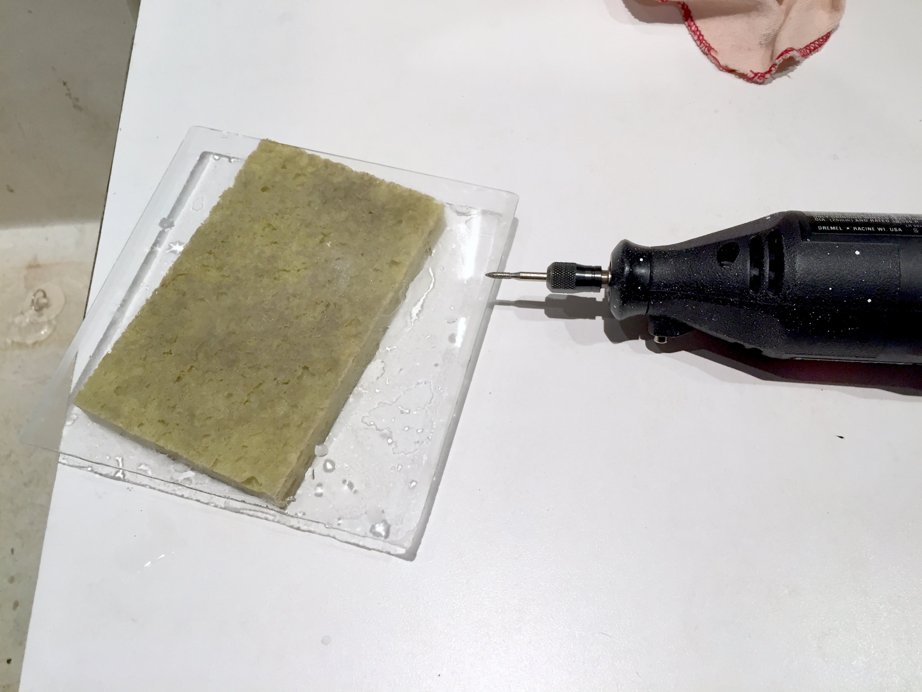

I cannot cut bevels to fit the Durst carriers, for example.
I needed some 4x5 negative carrier glass and was able to cut down some 5x7 Durst AN glass that had damage at the edges. The bevel was not as hard to create as I imagined. Keeping the glass wet, using a diamond bit and working slowly were the key elements.
