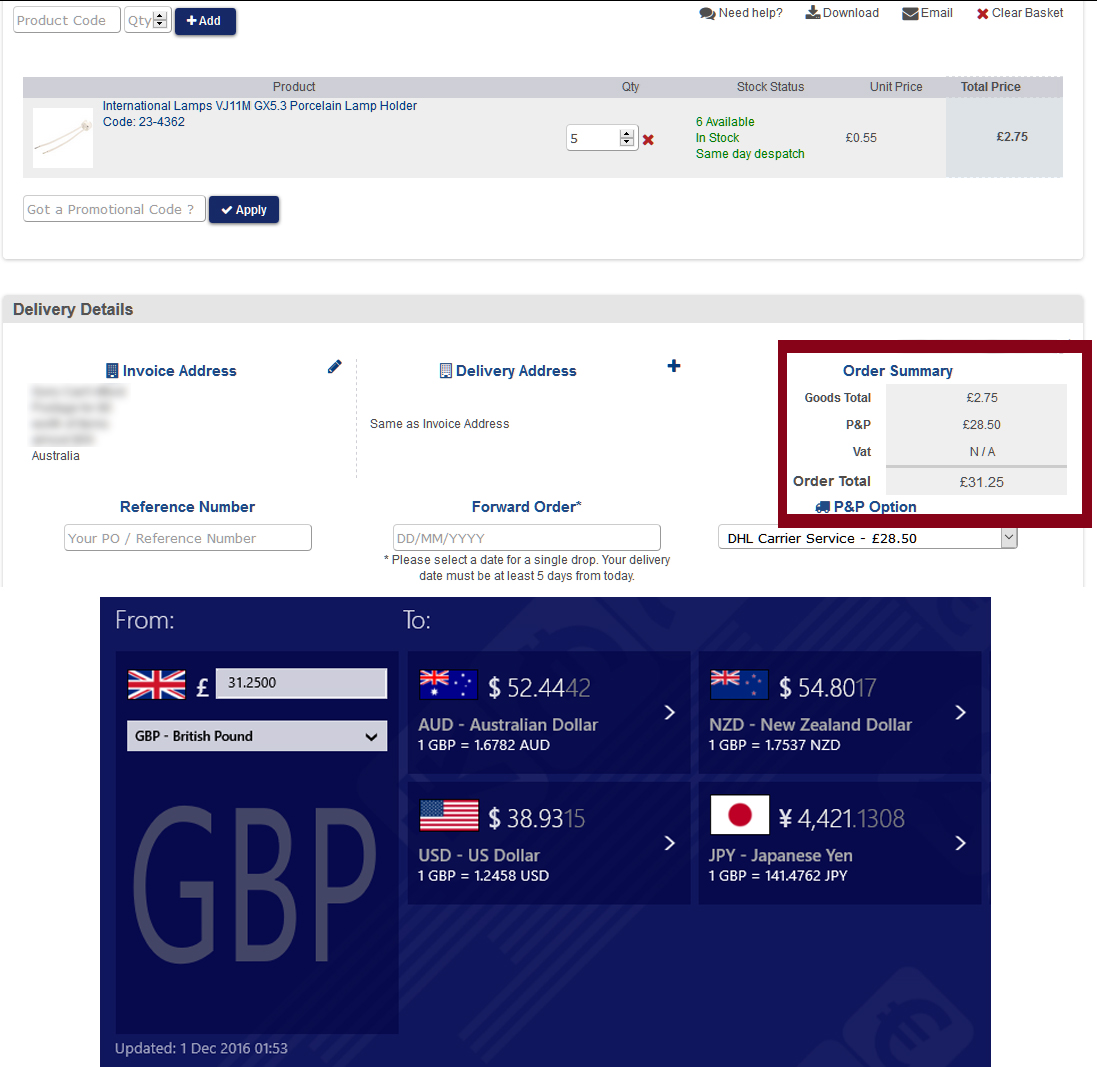

I've recently bought some new halogen globes for my LPL C7700 Colour Head Enlarger after much hunting around on the internet. What I REALLY need to replace, however, is the porcelain lamp holder which has more or less crumbled after many years of use. Locally and on ebay, I can find any number of sources rated up to 50 Watts, but the specific holder I'm looking for needs to be rated up to 100 Watts. I've found two sources in the UK, one being Maplin who don't ship to Australia, and the other is Rapid Electronics. It's a $1 item. Rapid Electronics sell only in quantities of five which is fine by me; I'd not order less for such a long trip overseas and I'm all about having back ups. After waiting a few weeks for them to have more than one in stock, I finally got my chance to order them this evening, however, upon typing in my postal address, I received the notification that postage is Twenty Eight Pounds! That brings my order up over the $50 (Australian) mark for five dollars worth of stock.
Does ANYONE know where I can buy a GX5.3 VJ11M Porcelain (Ceramic) Base? It is specifically rated for low voltages (12 Volts in this case) and up to 100 Watts.

G'day... I note their shipping carrier is DHL - a courier service. Ask them to price Royal Mail options which I am certain will be much cheaper. I recently bought from the UK, also something of little value & had my purchase shipped via Royal Mail. I used an untracked option saving heaps. Mind you, the delivery time was slower too... Fred

Have you tried Jaycar? I cannot remember if they carry these as a stock line, regardless I replaced mine in my DeVere enlarger earlier this year. From memory, it landed here from Mainland China for under $3.00.
A quick check of ebay au found this. http://www.ebay.com.au/itm/S-4-X-MR...661671?hash=item543ef784e7:g:17UAAMXQTT9RsO0~
There are cheaper ones there, (this is in Hong Kong so they are middlemen) but this was the first that had the specs you require that I came across.
