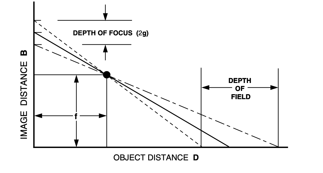

Here are 4 diagrams from a different site that are similar to the one that used to be on the Wikipedia “Depth of Field “article. I’ll refer to the second diagram.
https://physicsandphotography.wordpress.com/2014/10/02/depth-of-field/
Take the vertical red line to the left as the object plane and the red line on the right as the image plane. At the far left, the depth of field about the object plane extends from the blue line to the green line.
At the right, the corresponding depth of focus about the image plane extends from the green line to the blue line. The black “T-shaped” vertical lines illustrate the aperture.
These ideas work for any object-lens-image system. Older literature about optical systems used the term “depth of field” when discussing the fields of acceptable resolution about both the object and image planes. Later, “depth of field” was reserved for the object side and “depth of focus” for the image side fields. This is the usual practice now.
The entire article is useful and reasonably easy to understand, especially with the aid of the accompanying diagrams.

Yes. You understand correctly. The object and image planes lie at approximately the center of their respective fields.
You can see this in the second diagram in the Wordpress article from post #5.

The red line to the far right represents the image at the emulsion surface of the paper. The blue line is the near limit of DOF above the paper. The green line is the far limit of DOF below the paper.
The red line at the right side is the object plane at the emulsion of the negative. The blue line represents the upper limit of DOF above the negative. The green line is the lower limit of DOF below the negative.
ic-racer
Feb 25, 2007
16,696
USA
The diagram Ian C linked above to is actually a good diagram for the relations in photographic enlarging, as the field depth is about equally distributed on either side of the point of sharp focus on both sides of the lens at the distances usually encountered in the darkroom.
When diagramming this concept for a camera, in which the subject gets closer to infinity, the depth at the subject side extends farther behind the point of sharp focus as seen below:
Ian C
Feb 8, 2009
1,293
IC: Thank you for the diagrams. That makes the discussion much easier to understand and visualize.
For the example at the bottom of post #14 we get
Negative Plane:
Rounded to the nearest 0.01 mm, the DOF about the negative extends from 0.26 mm above the plane of the emulsion and extends to 0.26 mm below.
Image Plane:
The DOF about the print begins at 16.60 mm above and extends to 17.90 mm below the top surface of the paper.
