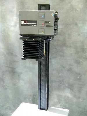

I've been on the lookout for an enlarger that allows me to print b&w in medium format and 4x5.
My two options available within my budget are the De Vere 504 Dichromat and an LPL 7451. Theyre around the same price budget wise but I've no experience of either models so was wondering if anyone could put forward any pros or cons of either.

I don't know much about the DeVere but LPLs are very well made units and what I would replace my Durst M600 with. Be patient as enlargers are declining in price all the time.

I have the LPL 4x5 model 4550XLG, this is the same basic chassis but with a slightly taller column, a slightly larger baseboard, it will make larger prints.
There are three light-projection heads, a simple head for B&W without facility for variable contrast filtration (filters can added below the lens); a color head (dichroic) that can be used for variable contrast B&W by conversion of the color dial settings (three) into contrast filtration factors (Ilford publishes such conversion tables among others); the third head is purpose made for variable contrast B&W printing with a single dial for contrast and automatic compensation for the change of speed for grades 3.5 - 5 (VCCE). This is a dream to use and is the one to have, they are sought after and cost more. The filtration modules for the VCCE and dichroic heads are interchangeable.
Shipping one of these needs extra care, it splits into three parts, base, column and head, and the head is heavy and delicate.
Make sure the power supply is included.
Operation of the focus control when making large prints requires the accessory focus extension shaft.
One of the best online sources of information is the website of KHBphotographix in Canada, they also have enlargers and parts for sale most of the time http://store.khbphotografix.com/

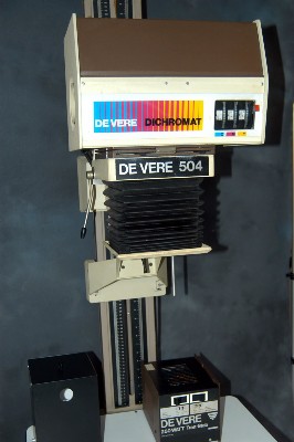

I would use the LPL as a starting block to get to almost any De Vere 504 enlarger, whether that be a free standing or a table top unit.
If the De Vere is a Mk IV with a single globe head, then it is probably around the 80's vintage. There were/are quite a few of these units in Australia and presumably NZ as well.
I had the first version of the LPL 7450 enlargers, wall mounted, they are well made, but not a patch on the De Vere enlarger.
The De Vere enlargers are amongst the best enlargers ever manufactured. Just the bellows extension alone on the De Vere, opens up considerable possibilities that most other enlargers dream about.
You can adjust the De Vere enlarger to get super critical alignment for almost any stage of the enlarging process. The LPL enlargers do not have any possibility to do adjustments. That doesn't mean they are bad, just that the factory setting is very good, as near to perfect as it can be. However, if over the life of the enlarger it is manhandled incorrectly, as in getting knocked over or dropped when being moved, you have no way of re-aligning your enlarger other than to pull it apart and re-bend any bent metal/alloy.
If the De Vere hasn't been worked to death, I would seriously consider it over the LPL 7451.
In Australia the two best enlargers that crop up, are the LPL units, mostly 6x7 with a fair sprinkling of their various 7450 units, and the ever present De Vere units.
Tedr1 has explained the LPL enlargers very well, they are excellent enlargers, but not quite as excellent as a good De Vere; they are the top of the tree.
Any pictures?
Mick.

These are the only images that don't really tell you much. They are from a company rather than private sale and can request further images if needed.
I am kind of leaning towards the De Vere if only because I've used them in the past.

I have the Saunders LPL 4500-II, which was the USA version of the LPL7451 at the time I bought it. I've been more than happy with its operation. I've never met an enlarger that operated so smoothly.
Useful accessories include the extension focusing wand--it lets you bend down to focus but not have to reach up to focus, and the 4-blade masking platform. Permits masking the edges of the negative to reduce potential flare.

I have a 4550 and it is a good enlarger. It is true that they don't have any adjustments for alignment, except for the latest ones which have an adjustment at the lens stage. You can just shim it though. Mine needed a little shim under the column and the lens stage has one as well. Works fine and doesn't go out of alignment. One little thing that bugs me about the 4550 is the 4x5 glass carrier cuts into the neg a little. Not sure who the nincompoop was who designed that little gem of a fault. One other thing to mention is if you have lenses that are non standard 39mm mount you could have trouble finding lens boards for them. They should be easy to machine though, so you could always get that done.
I've never used a DeVere, but they look like tanks. Frankly, either one should be fine.

That De Vere has the power supply, it also has a mixing chamber alongside, presumably the other one is in the head. They came with two mixing chambers, 4x5" and 6x7cm or 6x9cm (cannot remember which size it is). I leave my 4x5" mixing chamber permanently in the head and use it for everything from 35mm through to 4x5".
If you've used a De Vere in the past, why are you still hesitating over which one?

That DeVere is a pretty old one with an older style dichroic head. I have both a DeVere 5108 and both the LPL 4550-II and the XLG version. I'd get the LPL because it is a much simpler enlarger with much less to go wrong. The simplicity and the light source interchangeability gives it my nod. Also, the VCCE head is a joy to use. My DeVere is a very recent one (bought new in 1996) which is the enlarger I normally use, but it's a totally different beast than the one you're looking at.
I'd look at them both and get the one in the best shape. Parts for the LPL are going to be cheaper and more readily available than for the DeVere. If you're going to be msotly printing medium format the LPL with the VCCE head is going to be much easier to use for B&W.
