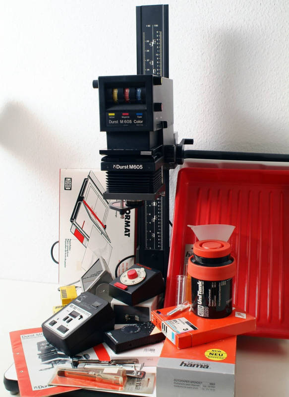

The one I'm interested in is a Durst M605.
Image provided by the seller is attached (hopefully).
Is it a good choice?

Should be very nice, very popular, parts and accessories readily available, although I am not familiar with the market where you live. If its priced to your satisfaction, go for it.

I'll most likely be outbid... my budget is not much... but I'll try :smile:

If it can be purchased locally and its in your budget, then buy it. Dursts are wonderful machines, and will last. If you only shoot 35mm or 6x6 it will do everything you need. Parts should not too hard to find.
