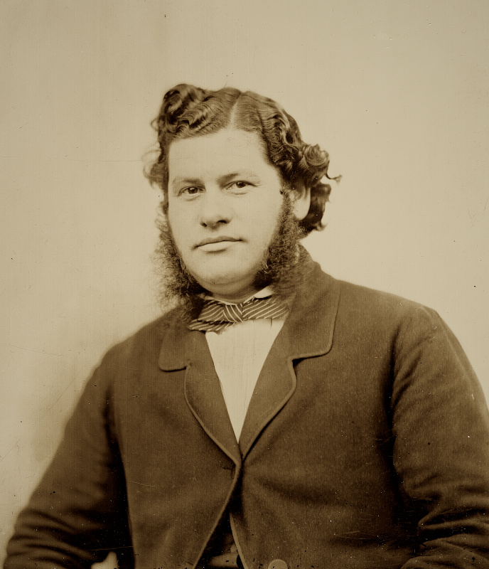

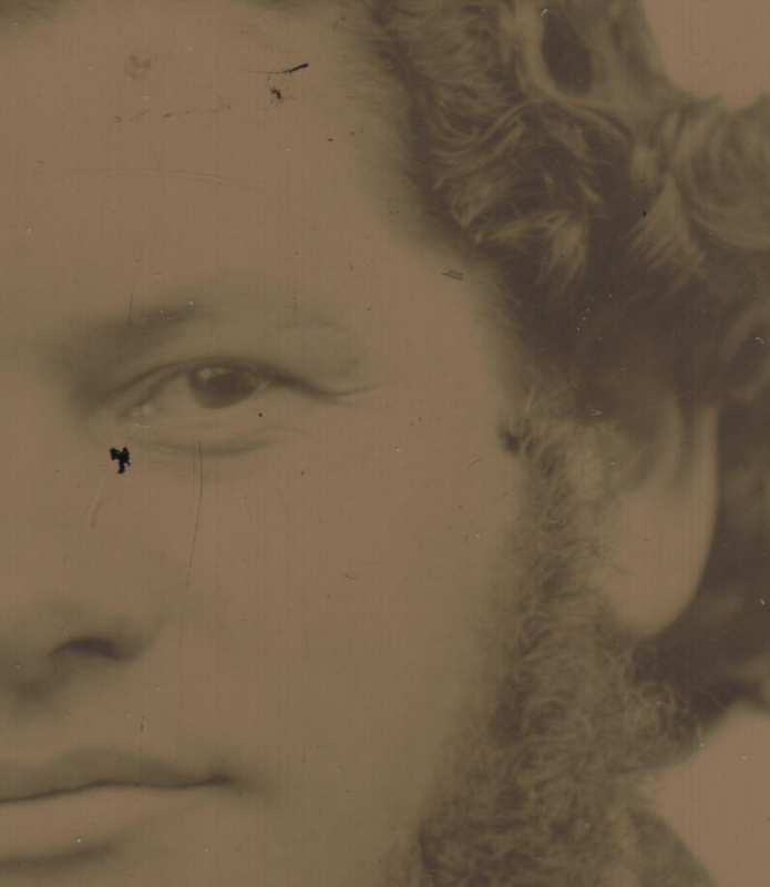

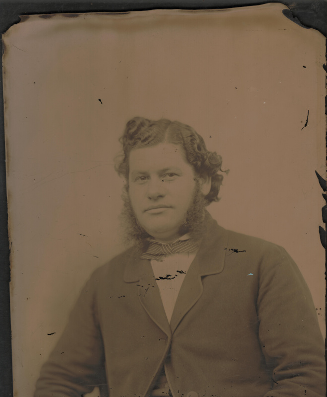

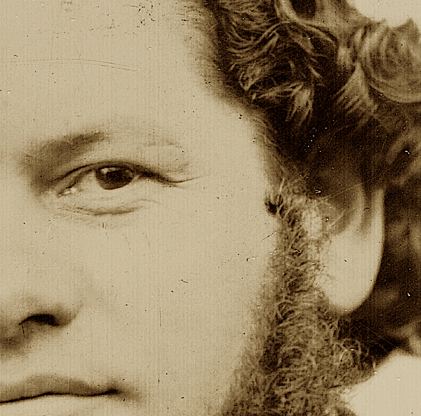

I've brushed up a few of my ancestors using a domestic flat bed scanner and then GIMP (no AI involved). Here's an example, from a glass negative. In this case, the scanner introduced an artefact (parallel lines like you get in quality paper), but they don't seem that important. More to the point, touching up the damaged areas and then tweaking contrast and sharpness revealed detail that you couldn't really see in the original.

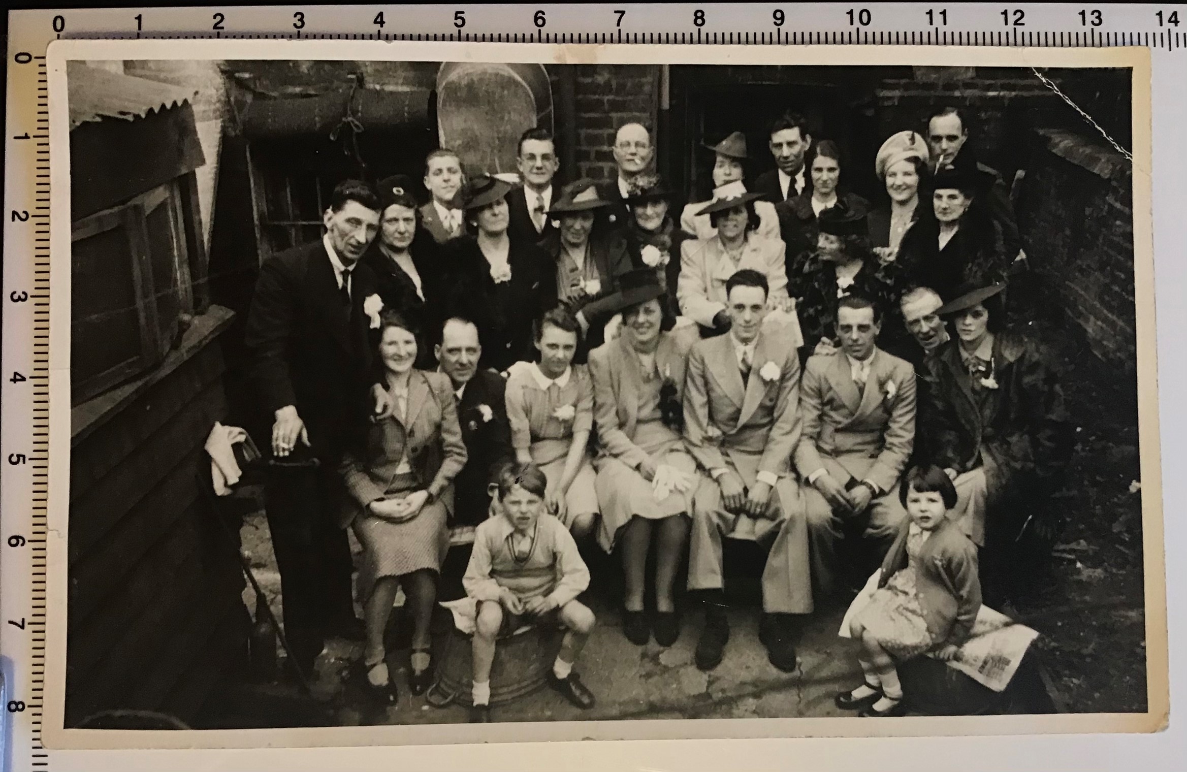

Here's the print I'm working with, this is an iPad photo which doesn't hold up to enlargment:
I wondered if this might be a contact print, it's just slightly larger than a 116 negative. Image is later than I thought, April 1941, East End of London, Kodak postcard paper, our only copy of the only photo taken that day. I've looked at it with a 10x loupe, and it is soft, there's not really any detail if you look close at faces.
Maybe 10x8 in unrealistic and as Matt says, 5x7 might be better. I like the look of a 5x7 photo on 10x8 paper. Maybe I could aim for that. I'm going to try scanning this on our HP flatbed later today.

I think that may be simply the old standard ‘postcard’ sized printing paper, 5.5 x 3.5 inches, which would not imply that it was a contact print necessarily. I could be wrong (often am!), but I don’t think those proportions exactly fitted any film format of the time.
That's the size negative from a postcard camera, so could have easily been a contact print.
There may have been a slight amount of camera shake that made everyone a little blurred. I'd say the negative was also somewhat overdeveloped. I think it could make a decent print on 8x10 - just not one you could hold in your hand and scrutinize. It's a good candidate for the AI enhancement software @Pieter12 suggested.

Ah, thanks for the education. I didn't know about postcard cameras or 122 film before. According to Wikipedia, 122 film was apparently discontinued in the 1970s, so clearly such a camera could easily have been in use still in the 1940s. By way of comparison, my grandmother used a Kodak folder with 616 film for several years after manufacture of that film size was discontinued in the 1980s.
I also noticed that there are different statements online about that standard postcard size. I had it in my head that it was 51/2 by 31/4, but amended my post #15 after checking an online source. But it seems the majority verdict confirms 31/4 inches.
Nice to notice details like the tin bath hanging at the back, and the indispensible cigarette in the hand of the gent on the left. And the kids sitting on newspaper to keep their best clothes clean. The boy seems to be sitting on a coal scuttle. I'm sure there's a lot more telling detail there about post-war Britain. [Edit: I’m an idiot: ‘about war-time Britain’, I should have said]
