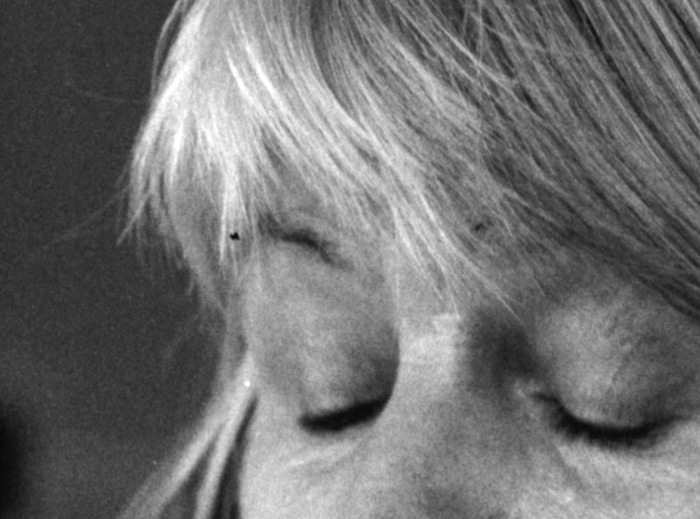

I felt for the holes this evening, and there's nothing. Neither is any damage to the emulsion visible, so these are probably not real pinholes. This makes me wonder again if dirt might be responsible, but that's hard to believe.
Here's a crop of a Delta 3200 120 neg showing a black speck, clear on the negative.

I trained as an industrial chemist (including some time dealing with surface coatings) and the black areas on your neg seem to be far too large and irregular in shape and distribution to be caused by pinholing due to any kind of chemical cause. They do look as I would expect from a physical cause such as dust on the unexposed film or physical damage to the emulsion (either through a scratch or poor adhesion of the emulsion to the substrate) .
If there were poor adhesion to the substrate it may be caused by contamination, again I would have expected far more widespread loss of adhesion.
None of this completely discounts the possibility of a rogue batch of substrate or emulsion, I would suggest you contact Ilford through this link http://www.ilford.com/html/us_english/directory/directory.asp
and ask them for a comment, obviously batch numbers etc. would be useful but I know how much notice I take of these !
Hope this is helpful

Ahem, I just got similar spots on two rolls of Tmax 400. So I think I can rule out emulsion problems (I'd change the title of the thread if I could!)
It has to be dirt. The odd thing is that it's in chunks or flecks. If it was just general household dirt I'd expect most of it to be fibers, like the dust that gets on negatives in the darkroom. I wonder if maybe I have crumbling foam somewhere inside the body (a Bronica SQ-A) or if static electricity contributes to the problem.

Pinholes caused by acidic stops or fix baths is pretty much a myth, especially with modern films.
I coat my own film and paper and use an acid stop and fix. I use glyoxal or chrome alum as hardener, and at 68 degrees I see no problem unless I make an error in the amount I add or the time I let the coating harden.
Peter, the spots are not indicative of any coating defect that I know of but there is one called 'pick off' that slightly resembles what I see. It takes place when one layer of film sticks to another when moist or damp and then is pulled apart. The emulsion layer sticks to the base and is then 'picked off' when pulled apart. This can also happen when film sticks to paper base.
Could your film have been refrigerated and opened too soon so that moisture condensed on it? Could it have been re-frozen? Is it humid when you open a pack? These are questions I would answer if I saw what you are seeing.
Another is this. Do you have a home humidifier? Some of these accumulate salts on the element that vibrate off into the air and form large 'dirt' particles that float like fine ash in the air and then drift onto things. Ours did that and I had to turn it off finally. That is another source of this type of problem.
PE
Thanks, PE. If this was the case, I should be able to see or feel physical damage to the emulsion, right? There would be a little pit or discontinuity?
PE
Interesting, but no, no humidifier. Now that you point it out, some of these specks seem to large to float in the air very long. I guess that points to some source in the camera, back, or film.
Photo Engineer
Apr 19, 2005
29,018
Rochester, NY
Pick off creates small 'craters' in the film that are irregular in shape and may go to any depth right to the support. The humidifier problem creates raised spots.
The first causes dark spots on prints and the second causes light spots on prints. I should have considered the latter more carefully when I posted it, as yours appear to be all irregular dark spots.
Just remember that most all coating defects are rather regular or smooth in shape like dots, comets, circles, or streaks, and cause depressions that resemble craters with sometimes raised lips just like craters. They most often are oriented in the direction of coating, which in normal film is lengthwise.
PE
psvensson
Apr 16, 2004
623
Queens, NY
PE
Interesting. These don't look anything like that.
