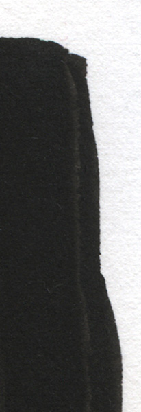

Hello All,
After quite a bit of testing I continue to have difficulty printing a pure palladium emulsion without getting some appearance of what I believe is solarization (or pseudo solarization). It appears in the darkest part of the coating outside of the image area and looks like a water stain, for lack of a better description. It's not a huge deal, but I would like to resolve it if possible. I have confirmed an appropriate exposure time several times and have varied the amount of sensitizer I am laying down (currently 24/24 for 8x10), but to no avail. I have read that adding platinum to the mix should resolve this issue. I was wondering if both Na2 and the standard potassium chloroplatinite will work equally effectively for this purpose. Are there advantages or disadvantages to using one or the other? What percentages of platinum in the sensitizer are typically effective? Any feedback is greatly appreciated.
Jeff

Jeff, the area outside of the image area gets the most exposure, hence contributing to the results you're seeing. Basic exposure time should be judged according to that area, the 'base + fog' area of the negative. I mention this because there are several ways in which people test for basic exposure time. That is, unless the area outside of your image is receiving direct UV with no blank negative laying over it. This will vary depending on whether you're using analog negs or digital ones...
If the problem exists outside the image area only, and you don't care about seeing brush marks in the borders, you can mask the perimeter with rubylith or red lithographers tape to eliminate them. Your clearing process must be very good (or use a dbl layer of tape or ruby) in order to avoid a grayness in that area.
Another thing to try, that I swear by, is to sandwich the coated paper/negative combo between the contact frame glass and a piece of mylar in order to prevent loss of humidity through the back of the paper. This will also help dMax...

I appreciate the reply. To be honest (dare I admit it here on APUG) I am printing with digital negs using Pictorico OHP Premium. The area shown in the attached pic was exposed through the Pictorico. I determine my exposure by the time at which additional exposure (through the OHP of course) will not yield additional print density. For example, with my current workflow I get increasing Dmax as I increase my exposure time to 3:30, exposing longer than 3:30 does not yield any increase in Dmax, so I set my exposure time to 3:30. I know this is somewhat of a departure from using a step wedge as some do, but the logic in it seems reasonable, no.
I have considered masking the negs in computer by simply creating a black border around the image area, and I haven't completely ruled out this option. Despite my conservative coating technique I would still really prefer to show the coated area outside of the image, thus I am hoping to resolve the issue.
I will give the mylar backing a shot. That combined with more rigorous humidification practices should at least make for a better print and hopefully help solve the issue.

As to masking, my coating area is barely larger than the negative itself. I reuse matts with the window to the size of the negative. Place the matt on the paper to be coated, and coat to the edges. At the end of coating, I'll remove matt; and lightly brush the edges. It still gives the hand coating appearance while reducing the border area susceptible to solarization.
