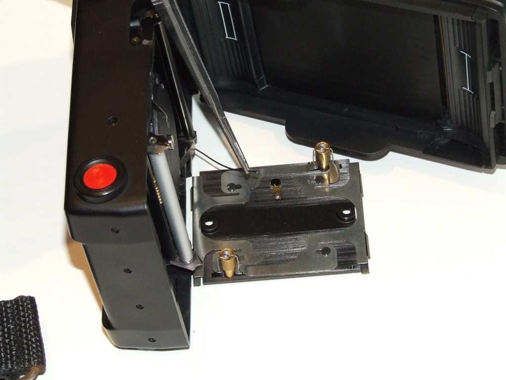

Also found a disconnected wire on the on-off switch for a Rollei 6008 that I successfully re-soldered.

Here is another loose wire. This Rollei 120 magazine was rendered in operable by a wire that had come loose. Easily re-attached to bring it back to life.
I likely would have substituted the wire for a more thicker, flexible cable, or at least, after resoldering put a drop of hot-glue (more flexible: silicone rubber) at the end to take bending-stress off the naked part of the wire.
