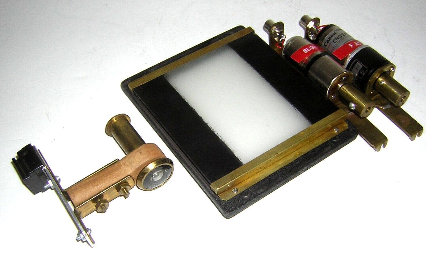

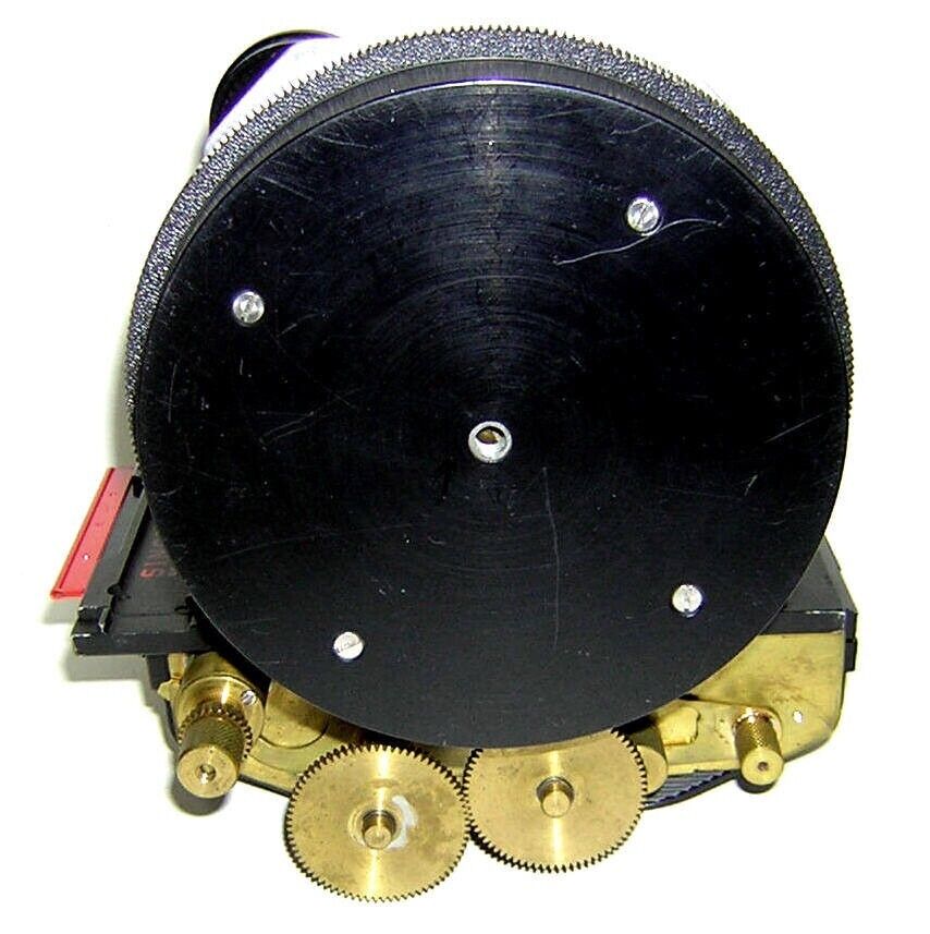

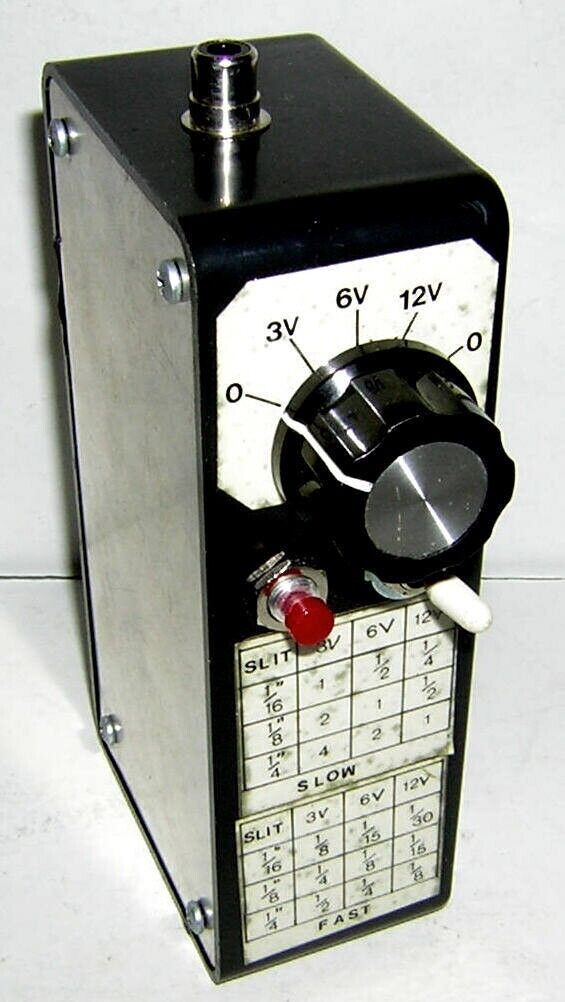

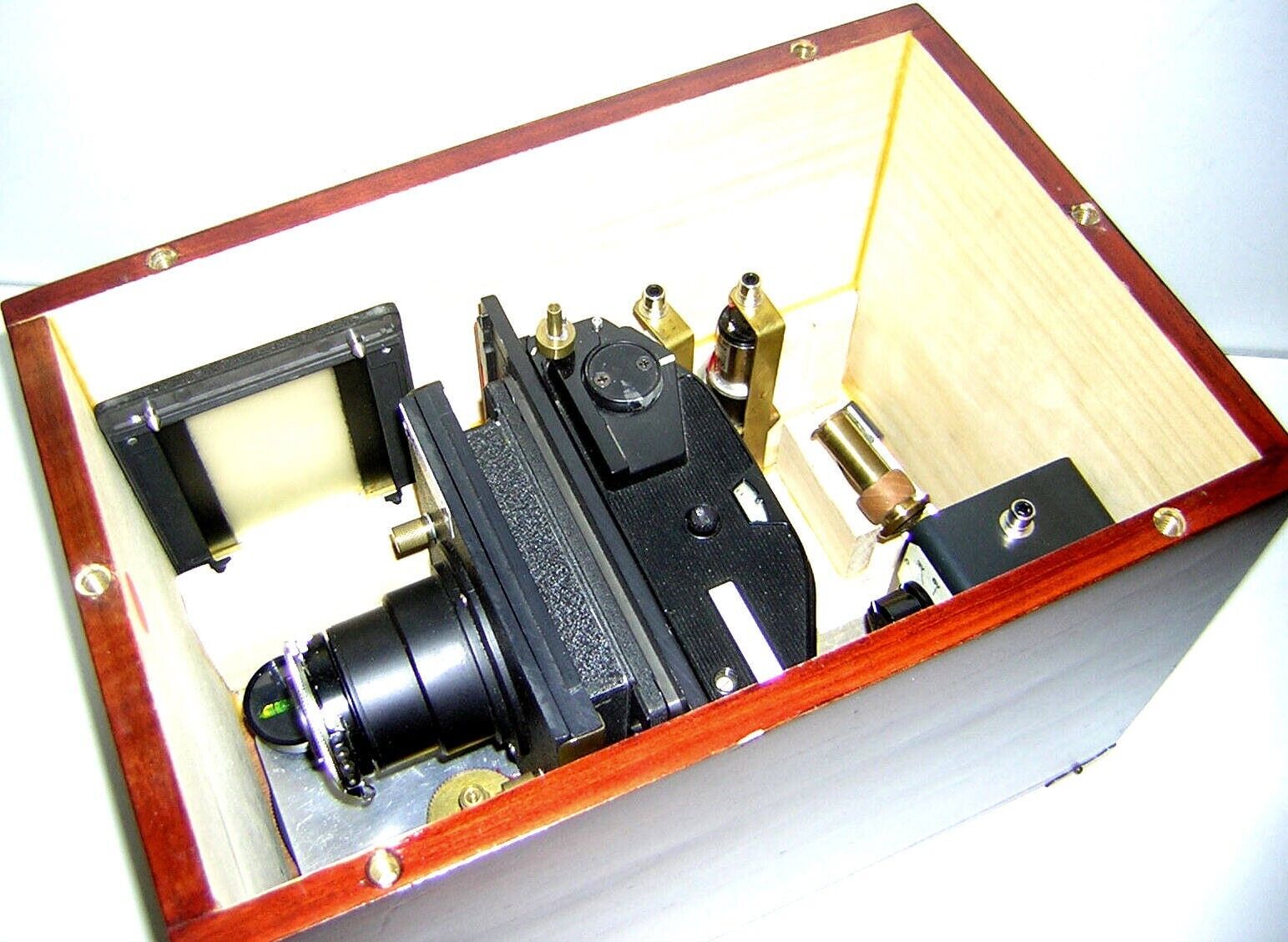

I figured I'd copy in those auction pictures here, for posterity. Wish I weren't so broke from buying building materials, I'd be all over this!
Duncan
