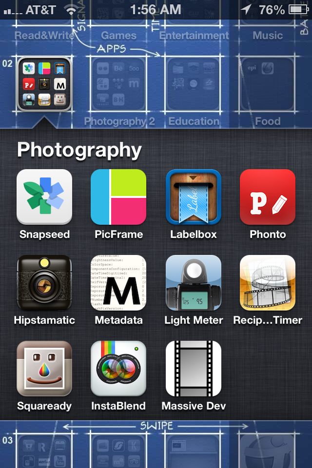

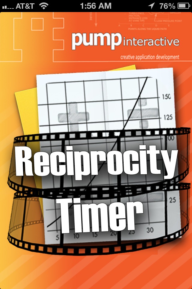

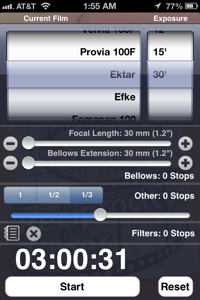

There's a reciprocity timer app that one of the film guys created, it only goes up to 30 minutes for Ektar (which I'm sure is Ektar100... he hasn't quite cleaned up the app so sometimes stuff isn't labeled exactly, but I do know he's starting with current films and moving backward to older films, so anyway... ) at 30 minutes, the timer goes to 3 hours 31 seconds... so if you're doing 1:30 hours... then your going to run into daylight issues where the light will change as the sun comes up... so that also becomes a factor (unless you're shooting in antarctica haha).
Anyway it's a paid app but really works well, I'll post an image (this is for iPhone).

Images... These are all highly recommended apps for different reasons (film only guys might not use all of them but can come in handy).
Hope this helps.
~Stone | Sent w/ iPhone using Tapatalk

That looks like a really great app Stone - for large format, I was recently shooting a 4-minute exposure and trying to figure out reciprocity times. I guess I need to top up my Apple account.
It is, it recalculates the time for bellows extension, which is pretty damn nice I would assume, I haven't used it for much as I haven't had the opportunity but the shots I already took in the 10-20 minute range look to be similar to the times given.
I know he takes the info from the data sheets provided by the manufacturer. That's all I know.
