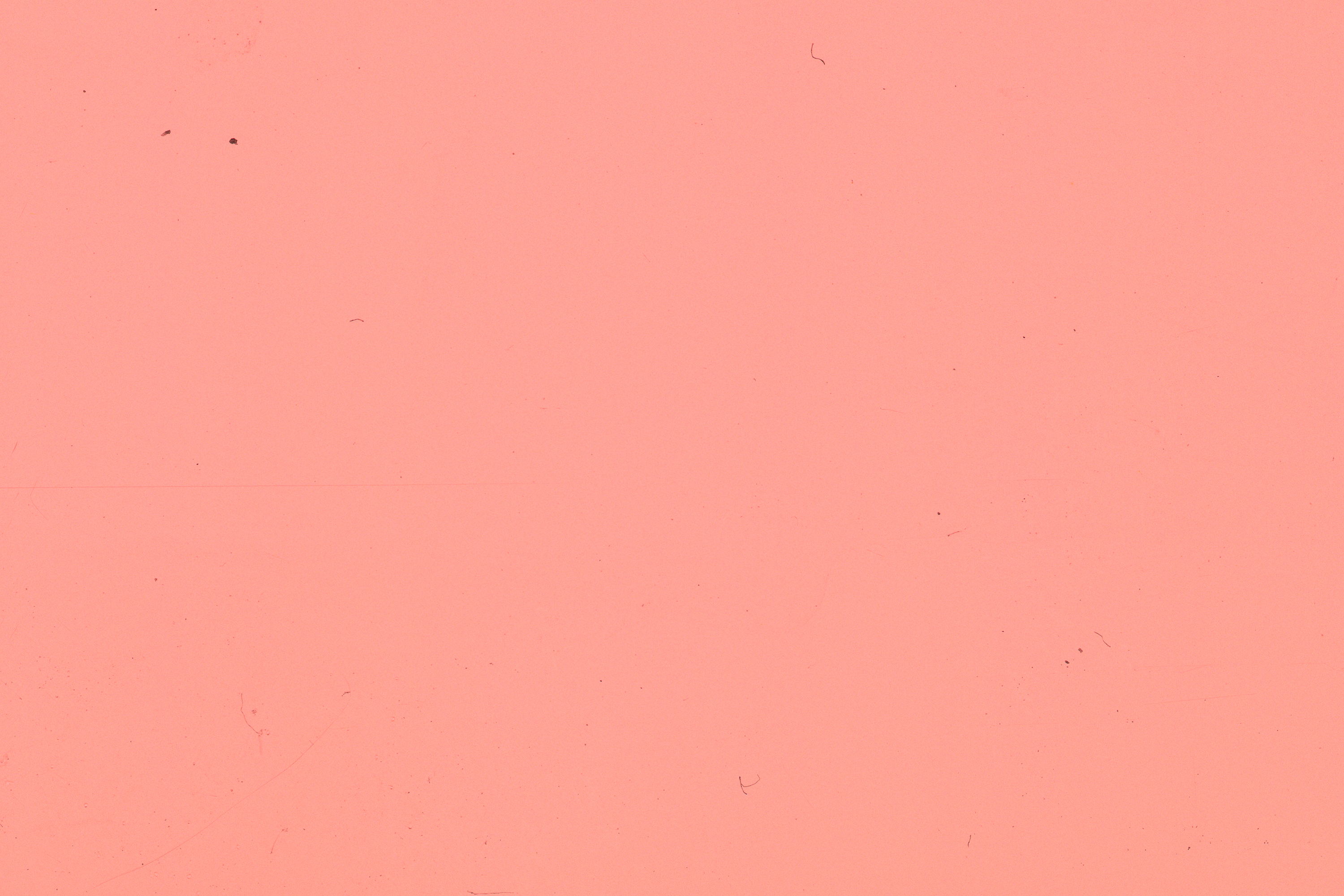

OK. Turns out, one of the frames from one of the 135 rolls (in this case the same roll from post #11) has an x-rite color checker chart in it, which makes evaluating this a little easier. I'm not set up to do analog prints, so this was scanned in with my basic vuescan-based workflow on a Pacific Image PrimeFilmXE scanner. I'll not go into minutae about it, but suffice it to say that that workflow isn't that much different from the many documented best practices for vuescan. If anybody wants to download the tiff files for close inspection in PS, they're in this zip file here. It's about 800MB.
A couple of things to note right off the bat... It's a lot denser than normal. For most other Ektar 135 rolls, I typically run the input gain on the scanner at 1.5 +- 0.125, on this roll, I jacked it up to 2.45 to get the red channel up to the same just about clipping level, so there's that. Other than that, this is the result of a quickie couple of scans and a basic curves layer in PS on one of the images (you can look at the curves in the zip file if you're interested). I was in a bit of a hurry, so the film didn't get a good cleaning beforehand, and I only spent a couple of minutes on the last image just to see if I could get it in the ball-park.
First a positive scan of the raw film base
Then a raw positive scan of the image
And then the post processed version

I thought this happens with exhausted blix.
If a Blix was used, sure. This particular case is with official Kodak chemicals, so, it's just a case of having a denser than expected negative. That may or may not be an issue if doing analog prints, but for scanning, having a denser negative is definitely not a practice that I want to be doing, as it leads to more scanner gain (and more noise in the output), and depending on how dense the negative is, a lot less discrete tone values in your highlight areas, which can lead to tone banding and other issues once you invert the image. For scanning, to a point, less dense is better.

Looks like simple overdevelopment.
PE
Now that there's been some discussion and I've scanned a roll in and looked at it, that's what I'm thinking too. I don't think my current temperature controller has fine enough control for real Kodak chemicals since they're clearly more active than what I've been using up till now and my old practice clearly is making negatives that are denser that what I'd prefer given that I'm hybrid. It's +- 1 degree F. I've found one on amazon that does 0.1 degree accuracy, and it's on it's way to me, so that should significantly tighten that up, though I'll have to do some testing.

I always do. I have kids, so I keep my chemistry locked up out in the garage and also have a small space by the washer/dryer set up to do development. In my case, my process is very much subject to the temperature of the garage, which is not climate controlled and vented to the outside, so if it's cold outside, it's cold in the garage.
If you do your development indoors, you'll still lose temperature, just not as fast, so it's generally a good practice to put your tank back in the tempering bath between agitation cycles. In my case I suspect my temperature was too hot, combined with real kodak chemicals, which resulted in overdevelopment.
With that being said, technically, looking at the scans, I'd be hard pressed to complain. The only real problem is the negative is denser than what it probably should be.
PE doesn't think that's from the bleach, and I'm using SM tank bleach, so I doubt it's the bleach as well, though I haven't done anything specific to rule it out other than trust that it's fine straight out of the packaging.
