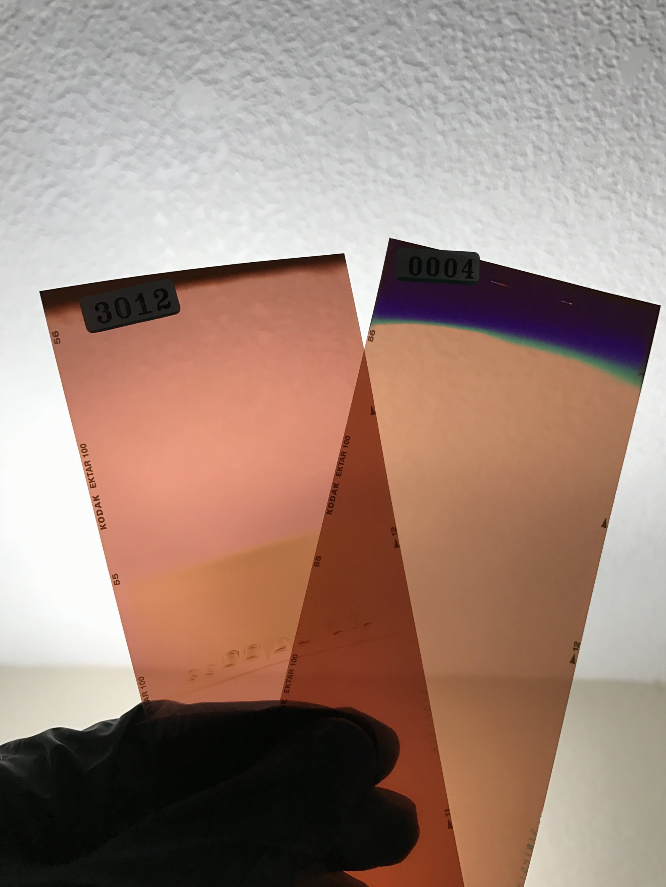

I recently came into a batch of Kodak flexicolor SM chemicals that are expiring 02-2018. I decided to run a few rolls of Ektar that I had stacked up through with it and the film base isn't quite the dusty rose color that I've gotten with other kits and from pro labs. I'm wondering if this is something I shouldn't worry about or if it's something wrong with the process I did with these chemicals?
The chemicals in question are Flex dev starter LORR 1.2L, dev replenisher LORR (makes 5L), SM tank fixer, SM tank bleach, and final wash.
I mixed up the dev and replenisher following the package instructions (it makes 6.5 L with a little replenisher left over), the bleach and fixer where used as is.
The process was as follows:
1. get everything up to 100 degrees in a 10 gallon water bath (water pump and bucket heater on a thermostat to maintain temperature, probably not scientific accurate, but way easier to maintain 100 +- 1 than through faucet and uses less water)
2. load the film into a paterson tank
3. pre-soak the film and tank in the the same water bath while staging everything to do the process (usually 4-5 minutes)
4. pour the pre-soak out, pour in the dev and put the lid on
5. every 15 seconds do 1 full inversion and put tank back in bath
6. at 3:05, pull tank out of bath, pour dev out
7. pour in stop bath (1:4 vinegar:water), agitate for 30 seconds let sit for another minute or so while staging the next step
8. pour out stop bath, pour in bleach, put lid on tank, do 2 full inversions every 30 seconds for 6:30
9. pour out bleach
10. rinse with 100 degree water for a couple minutes (dumping water and refilling every 30 seconds)
11. pour in fixer, put lid on, do 2 full inversions every 30 seconds for 6:30
12. pour out fixer
13. rinse the same as step 10, but for closer to 5 minutes
14. final rinse 1:30+, let it sit in it to keep it wet while clearing space to hang up to dry
Attached images between film from pro lab and above described process. Pro lab on the left, my run on the right. Definitely not the dusty rose film base I was expecting to see. I've not yet actually tried to do anything with the images to turn them into positives, but just looking at the negatives directly, they're images of familiar subjects, and don't seem off kilter color wise compared to other negatives of the same subject and light, but I won't know for sure until I scan them in.
Has anybody else had this happen?

I think you might be looking too hard; I wouldn't think twice about those results. In fact, I think you'd see the same thing if you sent the film to two different labs and compared the results. Too many variables at work. Your process looks fine (almost identical to mine; I might add a quick rinse after the stop) and at a glance, so does your negative.
Wet printing, if you're set up to do so, is the real test. If you can get accurate (or acceptable) colors with reasonable filtrations then you're good. Keep good notes. The real test is establishing consistency in your own process over time.

Maybe you didn't use developing starter or too little, if this is true the contrast of the image will be too high.
Thanks. I'd love to be able to wet print, but I just don't have the space to get it properly set up, so, for now, its scanning.

His notes indicate that he mixed it exactly as prescribed.
Yep. I used starter. Mixed it according to package instructions. This isn't my first time mixing or doing dev (though the first time with flexicolor chems), the only reason I said anything is because I'd previously consistently gotten a dusty rose film base, but that was with unicolor kits and my own alt process. If I send anything out, it goes to SF Photoworks and I get the same dusty rose film base on ektar with them too.

Negative base looks fine and with acceptable range I'd say. I don't think C-41 calls for stop-bath, so that might be affecting your results.

The process looks ok to me, but the support of the sample on the right is dark. The fogged area at the top is much too blue with not enough yellow. Whether this is bad or not will depend on the scans or prints. However, if it is bad, the film may have been fogged or the process too "hot" or both. I'm not sure yet.
Need prints.
PE
I don't think I fogged it because I've done 4 120 rolls and 3 135 rolls and got the same results on both formats. It's possible it's too hot if you're referring to temperature. I set the bucket heater thermostat to 101 because it's only 1 degree resolution/control. When I stick a thermometer in the bath it reads just barely a smidge above 100 after I've had the pump and heater going for an hour or so. I can do another run with 3 rolls of 135 in the next day or so with the heater set at 100 to see what it looks like. If you mean the mix is too hot, I followed the package instructions. It's possible I didn't get that right, but the instructions are pretty clear.
As far as the fogged area at the top, it was exposed to 2800K light when I put the twin check on it (yes I twincheck my own film), is it possible that would affect that?

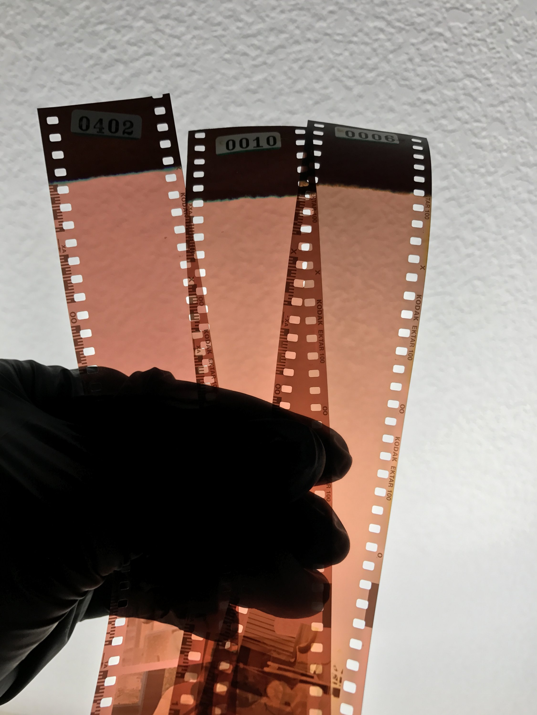

Here's a 135 sample from the same mix of chemicals. SF photoworks left, my run right. The ceiling is being lit by a LED at 5000K.
I've only got 1 liter left of the starter/replenisher mix left from this batch, but 7 more 5L replenisher packs and plenty of starter to still mix. I'm going to have a hard time going through it all before it goes bad in 02-2018 as by my calcs this is enough for at least a hundred rolls, and I'm going to be hard pressed to blast that many through before feb.

By "hot" I mean too active whether by temperature or mixing.
The fogged area in post #11 looks better but the clear area is too dark.

Here's a 135 sample from the same mix of chemicals. SF photoworks left, my run right...
I had a case like that with Ektar 100 few months ago when I extended development time with my reused developer. About the same happened with Portra 160 too. It turns out I should have kept development time at 3:15. If your times are right, chances are you run the process at a higher temperature.
That's what I'm thinking... I re-reviewed the package instructions and my mix notes for the replenisher and starter this evening just to double check myself, and I'm 100% certain I didn't screw up the mix proportions. I've always set my temp 1 degree higher on the temperature controller than what the instructions say and haven't had any issues, but this is the first time I've run proper flexicolor chemicals. All the other times, it's been either a unicolor kit or my own mix. Even at 1 degree higher, when I put a dial thermometer in the bath it is hotter than 100, but cooler than the 101 that the controller is set for. I get that there will be slight variations from lab to lab and run to run, but the second I looked at it the next day after it had dried I thought that's not the ektar 100 film base color I'm used to seeing. I've shot enough ektar 100 over the years, that I know what the normal film base looks like. I did a quick comparison to a known good (SF Photoworks), and sure enough, it's not the same. As others have said, they probably wouldn't think twice that something was wrong, and being a hybrid guy, I've no doubt that once scanned in, I could suss it into shape with little to no effort, and just run all my film this way without too much issue as long as I'm consistent, but I'd rather figure out why it's different, and fix that.
Tonight, I'm going to run 300ml of my last liter and do 1 roll of 135 with the temperature controller at 100 and no other changes. My worry with that is it won't be hot enough with the temp between 99 and 100. We'll see. If it comes out better, then I'll know it's the temperature, if it swings too far the other way, I might go back to 101 and try throttling back the time by taking the tank out of the bath at 3:00 instead of 3:05, then at 2:95 if it's better but still not right. If I'm going to run proper flexicolor, I might have to invest in a more precise temperature controller for the bucket heater.

had the same problem when I was developing Ektar at home. the base color looked different from what the labs gave me. Turned out the base was not the only think messed up. The entire image had a color shift that I could not correct. I assume the temperature wasn't stable enough during development.

Last nights run with the controller at 100. SF Photoworks on the left, last nights run in the middle, and the original run on the right. It's better, though still not there.

Adrian, I would not urge anyone to try that actually. I believe that it is a last ditch measure if you cannot control any other way.
As far as the film goes, it would be good to see some scans though. If they or prints are ok, there is no problem.
