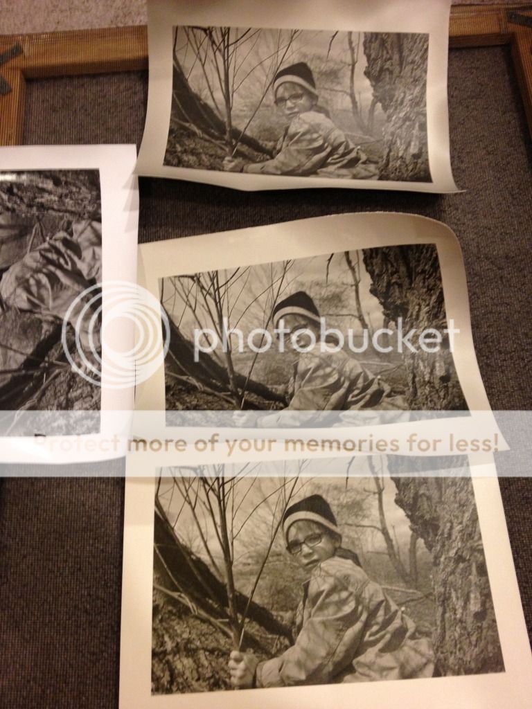

Resurrecting an old old thread to keep the topic in one place. Like the OP, I've some old Ektlure and printed some and saw some fog, so I've added 30ml of a 1% solution of benzotriazole (BZT) to my 1L of print dev. Thought since this is a photo site, thought I'd add a picture of the outcome in case anyone is wondering how BTZ impacts Ektlure FB. Below I have a photo of a standard MGIV FB glossy, w/o benzotriazole and with benzotriazole. It does make a bit of difference and a long fix (5 mins in a rapid fix sure helped too).
Fun paper! Love its texture and feel!
(Left - ref print, MGIV FB glossy, top no-BZT, bottom BZT):
(Left - no-BTZ, Right BZT):
Edit - Here is (Left - ref print, MGIV FB glossy, top right no-BZT, middle right BZT, bottom BZT and 2 grams potassium bromide) - had to double exposure after it was added since print got much lighter but gosh - the fog is gone and the paper is nice n cream!!!):
Question - Is there anyway to cool this? Say KRST 1:40 or I guess gold toner?

Update, now they are nice n dry, I took a quick pic of them all, left to right:
Ref print MGIV FB glossy, Ektalure GD lustre straight print, Ektalure GD lustre with BZT (30ml of a 1% sol added to 1L of Liquidol), Ektalure GD lustre with BZT and 2 grams of potassium bromide:

Hi - I made 1L of Liquidol (which I mix stronger than recommended 143 Liquidol to 857ml water), then I added 30ml of a 1% sol of BZT and 2grams of potassium bromide.
I did not try to print w/o the BZT and Potassium Bromide so I am not sure if it would have worked out as well w/o both.
This thread inspired me to do "the double duty" (BZT and Potassium Bromide). The BZT alone didn't do as well as when I added in the Potassium Bromide.
As I sit here and type, I've a Ektalure print that I did in BZT/potassium bromide in the wash after taking a 1min 20 sec bath in gold toner (T-26). Gosh does it pop! Will post a pic tomorrow or so after it drys.
Thomas, you are an old pro at Ektalure, does it work well with only potassium bromide or do you need the double duty of BZT and Potassium Bromide when the paper shows signs of fog? Thanks for the comments T.
