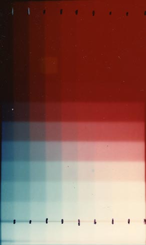

Example of color undercut exposure
I have had an envelope of these in my darkroom since the 80s. This is an 80s Ektachrome 64 printed onto either Ektaflex R or Radiance paper. I cannot tell which.
The exposure is a series showing the color gamut from red to cyan. To do justice to this, the entire series consisted of neutrals, magenta to green, yellow to blue and etc, and was usually both examined spectrophotographically and densitometrically.
The exposure was made on the film using WR 98,99 and 70 filters with a crossed step chart, and the prints onto the paper were made with corrected white light.
It was also done on negative film. I'll try to post more later. I have one other set.

After reading this over, I think it needs clarification. The experiment consists of 3 parts.
1. Expose film to WR 98, 99 and 70 filters to make the original grid. This shows what the film can do all on its own.
2. Expose the paper to the same grid with the same filters to show what the paper does on its own.
3. Expose the film results from #1 onto the paper with white light to show what the SYSTEM is capable of.
Optional extras include real photos shot alongside and printed alongside these with a reference color checker in the scene, and also with resolution charts.
This is part of the design stage of Ektachrome Film and Ektachrome Paper.

Seems like some serious red blocking up.
Thanks, this is really interesting. How precise is the scan?

The scan is fair. The blocking is partly an artifact of being exposed so as to insure a complete sensitometric scale is reproduced and some extra.
However, this is pos-pos and that is typically subject to blocking anyhow as I have repeatedly said.

I might also point out that this was an experiment run nearly 25 years ago and just sitting around in an envelope in my darkroom. IDK what it even consisted of except that it demonstrates the general methodology of testing for you.
So, please don't judge it or anything else I post as representative as it may not even have been any sort of a product. I merely had a sample sheet in my DR.
